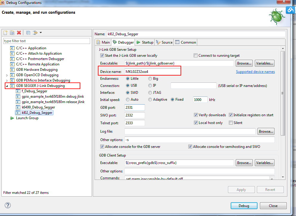

Hello Rick,
- How to configure the debug configurations ? Please check the Device name :
And if still can not work well , please show the error .

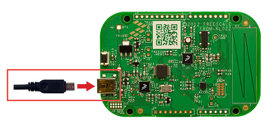

- And you also can use the usb (j2) directly to connect and debug (need not use connect emulator), only need drag and drop the file of
"DEBUG-APP_v105_Pemicro.SDA" to the bootloader, then when debug select the "GDB PEMicro Interace Debugging".
Hope it helps
