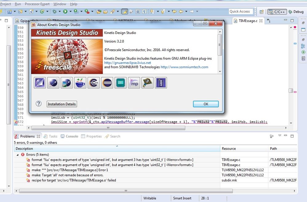

denisdantas
Hey there ZhangJennie,
I'm using KDS 3.2, but I still get the error. Do you have any idea what may be the problem?

ZhangJennie
Hi Denis,
as the demo code and video I attached in my first response. PRlu32 works normal from my side. did you download my demo code to test it on your side? how does it work?
could you upload your demo code to me thus I can check the problem directly from my side? thanks!
Jennie Zhang
4,022 次查看
ZhangJennie
Hi Denis Dantas.
macro PRIu32 is defined in inttyypes.h. so it's necessary to include inttypes.h to the source.
here is my testing code, there is no problem to build it under KDS3.2 Cross ARM GCC. I also attach the demo code and video.Can this help you?
