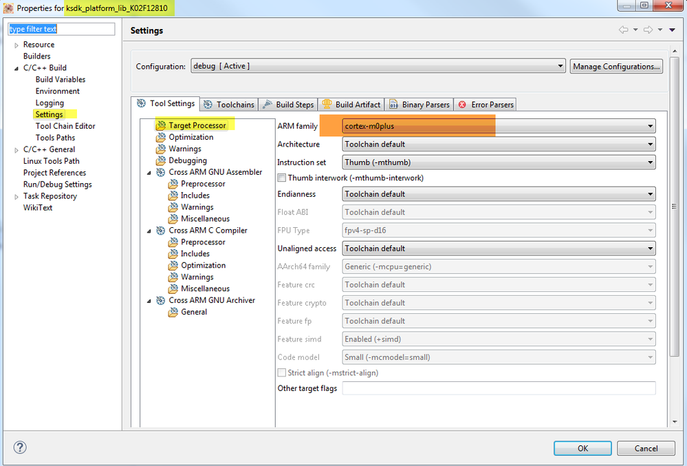

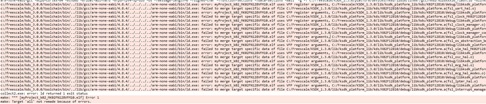

I created a new project with KSDK project generator for MK02FN128. port the .wsd to KDS, I have errors:
then I found there is problem in ksdk_platform_lib_K02F12810 properties setting: the default target processor is cortex-m0plus!

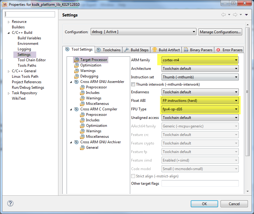

because K02 is cortex m4 core, so I modify ksdk_platform_lib_K02F12810 target setting as:
rebuild the library project. the rebuild user project. the error was gone on my side.
you can download this K02F128 project to FRDM-K22F board without problem. so I suggest you use K02F128 project+FRDM-K22F board to start your project.

I created project using project tool and imported project in workspace. After doing this I got 2 folder
1. Platform_lib for K02F128
2. Project folder
I build first library folder I got below data:
11:14:21 **** Incremental Build of configuration debug for project ksdk_platform_lib_K02F12810 ****
make -k all
make: Nothing to be done for `all'.
11:14:22 Build Finished (took 1s.450ms)
Then I tried building project folder I got lot many errors:
11:17:15 **** Incremental Build of configuration debug for project sw_gear_MK02FN128VFM10 ****
make -k all
'Building file: C:/Freescale/KSDK_1.3.0_/platform/utilities/src/fsl_debug_console.c'
'Invoking: Cross ARM C Compiler'
arm-none-eabi-gcc -mcpu=cortex-m4 -mthumb -mfloat-abi=hard -mfpu=fpv4-sp-d16 -Os -fmessage-length=0 -fsigned-char -ffunction-sections -fdata-sections -Wall -g -DDEBUG -DCPU_MK02FN128VFM10 -IC:/Freescale/KSDK_1.3.0_/platform/osa/inc -IC:/Freescale/KSDK_1.3.0_/platform/utilities/inc -IC:/Freescale/KSDK_1.3.0_/platform/CMSIS/Include -IC:/Freescale/KSDK_1.3.0_/platform/devices -IC:/Freescale/KSDK_1.3.0_/platform/devices/MK02F12810/include -IC:/Freescale/KSDK_1.3.0_/platform/devices/MK02F12810/startup -IC:/Freescale/KSDK_1.3.0_/platform/hal/inc -IC:/Freescale/KSDK_1.3.0_/platform/drivers/inc -IC:/Freescale/KSDK_1.3.0_/platform/system/inc -I../../ -IC:/Freescale/KSDK_1.3.0_/platform/drivers/src/adc16 -IC:/Freescale/KSDK_1.3.0_/platform/drivers/src/cmp -IC:/Freescale/KSDK_1.3.0_/platform/drivers/src/crc -IC:/Freescale/KSDK_1.3.0_/platform/drivers/src/dac -IC:/Freescale/KSDK_1.3.0_/platform/drivers/src/dspi -IC:/Freescale/KSDK_1.3.0_/platform/drivers/src/edma -IC:/Freescale/KSDK_1.3.0_/platform/drivers/src/ewm -IC:/Freescale/KSDK_1.3.0_/platform/drivers/src/ftm -IC:/Freescale/KSDK_1.3.0_/platform/drivers/src/gpio -IC:/Freescale/KSDK_1.3.0_/platform/drivers/src/i2c -IC:/Freescale/KSDK_1.3.0_/platform/drivers/src/lptmr -IC:/Freescale/KSDK_1.3.0_/platform/drivers/src/pdb -IC:/Freescale/KSDK_1.3.0_/platform/drivers/src/pit -IC:/Freescale/KSDK_1.3.0_/platform/drivers/src/uart -IC:/Freescale/KSDK_1.3.0_/platform/drivers/src/vref -IC:/Freescale/KSDK_1.3.0_/platform/drivers/src/wdog -std=gnu99 -fno-common -ffreestanding -fno-builtin -mapcs -MMD -MP -MF"utilities/fsl_debug_console.d" -MT"utilities/fsl_debug_console.o" -c -o "utilities/fsl_debug_console.o" "C:/Freescale/KSDK_1.3.0_/platform/utilities/src/fsl_debug_console.c"
'Finished building: C:/Freescale/KSDK_1.3.0_/platform/utilities/src/fsl_debug_console.c'
'Building file: C:/Freescale/KSDK_1.3.0_/platform/utilities/src/print_scan.c'
arm-none-eabi-gcc -mcpu=cortex-m4 -mthumb -mfloat-abi=hard -mfpu=fpv4-sp-d16 -Os -fmessage-length=0 -fsigned-char -ffunction-sections -fdata-sections -Wall -g -DDEBUG -DCPU_MK02FN128VFM10 -IC:/Freescale/KSDK_1.3.0_/platform/osa/inc -IC:/Freescale/KSDK_1.3.0_/platform/utilities/inc -IC:/Freescale/KSDK_1.3.0_/platform/CMSIS/Include -IC:/Freescale/KSDK_1.3.0_/platform/devices -IC:/Freescale/KSDK_1.3.0_/platform/devices/MK02F12810/include -IC:/Freescale/KSDK_1.3.0_/platform/devices/MK02F12810/startup -IC:/Freescale/KSDK_1.3.0_/platform/hal/inc -IC:/Freescale/KSDK_1.3.0_/platform/drivers/inc -IC:/Freescale/KSDK_1.3.0_/platform/system/inc -I../../ -IC:/Freescale/KSDK_1.3.0_/platform/drivers/src/adc16 -IC:/Freescale/KSDK_1.3.0_/platform/drivers/src/cmp -IC:/Freescale/KSDK_1.3.0_/platform/drivers/src/crc -IC:/Freescale/KSDK_1.3.0_/platform/drivers/src/dac -IC:/Freescale/KSDK_1.3.0_/platform/drivers/src/dspi -IC:/Freescale/KSDK_1.3.0_/platform/drivers/src/edma -IC:/Freescale/KSDK_1.3.0_/platform/drivers/src/ewm -IC:/Freescale/KSDK_1.3.0_/platform/drivers/src/ftm -IC:/Freescale/KSDK_1.3.0_/platform/drivers/src/gpio -IC:/Freescale/KSDK_1.3.0_/platform/drivers/src/i2c -IC:/Freescale/KSDK_1.3.0_/platform/drivers/src/lptmr -IC:/Freescale/KSDK_1.3.0_/platform/drivers/src/pdb -IC:/Freescale/KSDK_1.3.0_/platform/drivers/src/pit -IC:/Freescale/KSDK_1.3.0_/platform/drivers/src/uart -IC:/Freescale/KSDK_1.3.0_/platform/drivers/src/vref -IC:/Freescale/KSDK_1.3.0_/platform/drivers/src/wdog -std=gnu99 -fno-common -ffreestanding -fno-builtin -mapcs -MMD -MP -MF"utilities/print_scan.d" -MT"utilities/print_scan.o" -c -o "utilities/print_scan.o" "C:/Freescale/KSDK_1.3.0_/platform/utilities/src/print_scan.c"
'Finished building: C:/Freescale/KSDK_1.3.0_/platform/utilities/src/print_scan.c'
'Building file: C:/Freescale/KSDK_1.3.0_/platform/devices/startup.c'
arm-none-eabi-gcc -mcpu=cortex-m4 -mthumb -mfloat-abi=hard -mfpu=fpv4-sp-d16 -Os -fmessage-length=0 -fsigned-char -ffunction-sections -fdata-sections -Wall -g -DDEBUG -DCPU_MK02FN128VFM10 -IC:/Freescale/KSDK_1.3.0_/platform/osa/inc -IC:/Freescale/KSDK_1.3.0_/platform/utilities/inc -IC:/Freescale/KSDK_1.3.0_/platform/CMSIS/Include -IC:/Freescale/KSDK_1.3.0_/platform/devices -IC:/Freescale/KSDK_1.3.0_/platform/devices/MK02F12810/include -IC:/Freescale/KSDK_1.3.0_/platform/devices/MK02F12810/startup -IC:/Freescale/KSDK_1.3.0_/platform/hal/inc -IC:/Freescale/KSDK_1.3.0_/platform/drivers/inc -IC:/Freescale/KSDK_1.3.0_/platform/system/inc -I../../ -IC:/Freescale/KSDK_1.3.0_/platform/drivers/src/adc16 -IC:/Freescale/KSDK_1.3.0_/platform/drivers/src/cmp -IC:/Freescale/KSDK_1.3.0_/platform/drivers/src/crc -IC:/Freescale/KSDK_1.3.0_/platform/drivers/src/dac -IC:/Freescale/KSDK_1.3.0_/platform/drivers/src/dspi -IC:/Freescale/KSDK_1.3.0_/platform/drivers/src/edma -IC:/Freescale/KSDK_1.3.0_/platform/drivers/src/ewm -IC:/Freescale/KSDK_1.3.0_/platform/drivers/src/ftm -IC:/Freescale/KSDK_1.3.0_/platform/drivers/src/gpio -IC:/Freescale/KSDK_1.3.0_/platform/drivers/src/i2c -IC:/Freescale/KSDK_1.3.0_/platform/drivers/src/lptmr -IC:/Freescale/KSDK_1.3.0_/platform/drivers/src/pdb -IC:/Freescale/KSDK_1.3.0_/platform/drivers/src/pit -IC:/Freescale/KSDK_1.3.0_/platform/drivers/src/uart -IC:/Freescale/KSDK_1.3.0_/platform/drivers/src/vref -IC:/Freescale/KSDK_1.3.0_/platform/drivers/src/wdog -std=gnu99 -fno-common -ffreestanding -fno-builtin -mapcs -MMD -MP -MF"startup/startup.d" -MT"startup/startup.o" -c -o "startup/startup.o" "C:/Freescale/KSDK_1.3.0_/platform/devices/startup.c"
'Finished building: C:/Freescale/KSDK_1.3.0_/platform/devices/startup.c'
'Building file: C:/Freescale/KSDK_1.3.0_/platform/devices/MK02F12810/startup/system_MK02F12810.c'
arm-none-eabi-gcc -mcpu=cortex-m4 -mthumb -mfloat-abi=hard -mfpu=fpv4-sp-d16 -Os -fmessage-length=0 -fsigned-char -ffunction-sections -fdata-sections -Wall -g -DDEBUG -DCPU_MK02FN128VFM10 -IC:/Freescale/KSDK_1.3.0_/platform/osa/inc -IC:/Freescale/KSDK_1.3.0_/platform/utilities/inc -IC:/Freescale/KSDK_1.3.0_/platform/CMSIS/Include -IC:/Freescale/KSDK_1.3.0_/platform/devices -IC:/Freescale/KSDK_1.3.0_/platform/devices/MK02F12810/include -IC:/Freescale/KSDK_1.3.0_/platform/devices/MK02F12810/startup -IC:/Freescale/KSDK_1.3.0_/platform/hal/inc -IC:/Freescale/KSDK_1.3.0_/platform/drivers/inc -IC:/Freescale/KSDK_1.3.0_/platform/system/inc -I../../ -IC:/Freescale/KSDK_1.3.0_/platform/drivers/src/adc16 -IC:/Freescale/KSDK_1.3.0_/platform/drivers/src/cmp -IC:/Freescale/KSDK_1.3.0_/platform/drivers/src/crc -IC:/Freescale/KSDK_1.3.0_/platform/drivers/src/dac -IC:/Freescale/KSDK_1.3.0_/platform/drivers/src/dspi -IC:/Freescale/KSDK_1.3.0_/platform/drivers/src/edma -IC:/Freescale/KSDK_1.3.0_/platform/drivers/src/ewm -IC:/Freescale/KSDK_1.3.0_/platform/drivers/src/ftm -IC:/Freescale/KSDK_1.3.0_/platform/drivers/src/gpio -IC:/Freescale/KSDK_1.3.0_/platform/drivers/src/i2c -IC:/Freescale/KSDK_1.3.0_/platform/drivers/src/lptmr -IC:/Freescale/KSDK_1.3.0_/platform/drivers/src/pdb -IC:/Freescale/KSDK_1.3.0_/platform/drivers/src/pit -IC:/Freescale/KSDK_1.3.0_/platform/drivers/src/uart -IC:/Freescale/KSDK_1.3.0_/platform/drivers/src/vref -IC:/Freescale/KSDK_1.3.0_/platform/drivers/src/wdog -std=gnu99 -fno-common -ffreestanding -fno-builtin -mapcs -MMD -MP -MF"startup/system_MK02F12810.d" -MT"startup/system_MK02F12810.o" -c -o "startup/system_MK02F12810.o" "C:/Freescale/KSDK_1.3.0_/platform/devices/MK02F12810/startup/system_MK02F12810.c"
'Finished building: C:/Freescale/KSDK_1.3.0_/platform/devices/MK02F12810/startup/system_MK02F12810.c'
'Building file: C:/Freescale/KSDK_1.3.0_/user_projects/sw_gear/main.c'
arm-none-eabi-gcc -mcpu=cortex-m4 -mthumb -mfloat-abi=hard -mfpu=fpv4-sp-d16 -Os -fmessage-length=0 -fsigned-char -ffunction-sections -fdata-sections -Wall -g -DDEBUG -DCPU_MK02FN128VFM10 -IC:/Freescale/KSDK_1.3.0_/platform/osa/inc -IC:/Freescale/KSDK_1.3.0_/platform/utilities/inc -IC:/Freescale/KSDK_1.3.0_/platform/CMSIS/Include -IC:/Freescale/KSDK_1.3.0_/platform/devices -IC:/Freescale/KSDK_1.3.0_/platform/devices/MK02F12810/include -IC:/Freescale/KSDK_1.3.0_/platform/devices/MK02F12810/startup -IC:/Freescale/KSDK_1.3.0_/platform/hal/inc -IC:/Freescale/KSDK_1.3.0_/platform/drivers/inc -IC:/Freescale/KSDK_1.3.0_/platform/system/inc -I../../ -IC:/Freescale/KSDK_1.3.0_/platform/drivers/src/adc16 -IC:/Freescale/KSDK_1.3.0_/platform/drivers/src/cmp -IC:/Freescale/KSDK_1.3.0_/platform/drivers/src/crc -IC:/Freescale/KSDK_1.3.0_/platform/drivers/src/dac -IC:/Freescale/KSDK_1.3.0_/platform/drivers/src/dspi -IC:/Freescale/KSDK_1.3.0_/platform/drivers/src/edma -IC:/Freescale/KSDK_1.3.0_/platform/drivers/src/ewm -IC:/Freescale/KSDK_1.3.0_/platform/drivers/src/ftm -IC:/Freescale/KSDK_1.3.0_/platform/drivers/src/gpio -IC:/Freescale/KSDK_1.3.0_/platform/drivers/src/i2c -IC:/Freescale/KSDK_1.3.0_/platform/drivers/src/lptmr -IC:/Freescale/KSDK_1.3.0_/platform/drivers/src/pdb -IC:/Freescale/KSDK_1.3.0_/platform/drivers/src/pit -IC:/Freescale/KSDK_1.3.0_/platform/drivers/src/uart -IC:/Freescale/KSDK_1.3.0_/platform/drivers/src/vref -IC:/Freescale/KSDK_1.3.0_/platform/drivers/src/wdog -std=gnu99 -fno-common -ffreestanding -fno-builtin -mapcs -MMD -MP -MF"sources/main.d" -MT"sources/main.o" -c -o "sources/main.o" "C:/Freescale/KSDK_1.3.0_/user_projects/sw_gear/main.c"
'Finished building: C:/Freescale/KSDK_1.3.0_/user_projects/sw_gear/main.c'
'Building target: sw_gear_MK02FN128VFM10.elf'
'Invoking: Cross ARM C Linker'
arm-none-eabi-gcc -mcpu=cortex-m4 -mthumb -mfloat-abi=hard -mfpu=fpv4-sp-d16 -Os -fmessage-length=0 -fsigned-char -ffunction-sections -fdata-sections -Wall -g -T C:/Freescale/KSDK_1.3.0_/platform/devices/MK02F12810/linker/gcc/MK02FN128xxx10_flash.ld -Xlinker --gc-sections -Wl,-Map,"sw_gear_MK02FN128VFM10.map" -Xlinker -z -Xlinker muldefs --specs=nano.specs -Wall -fno-common -ffunction-sections -fdata-sections -ffreestanding -fno-builtin -Os -mapcs -Xlinker -static -o "sw_gear_MK02FN128VFM10.elf" -Xlinker --start-group ./utilities/fsl_debug_console.o ./utilities/print_scan.o ./startup/startup.o ./startup/startup_MK02F12810.o ./startup/system_MK02F12810.o ./sources/main.o C:/Freescale/KSDK_1.3.0_/lib/ksdk_platform_lib/kds/K02F12810/debug/libksdk_platform.a -lm -lg -lgcc -lnosys -Xlinker --end-group
c:/freescale/kds_3.0.0/toolchain/bin/../lib/gcc/arm-none-eabi/4.8.4/../../../../arm-none-eabi/bin/ld.exe: error: sw_gear_MK02FN128VFM10.elf uses VFP register arguments, C:/Freescale/KSDK_1.3.0_/lib/ksdk_platform_lib/kds/K02F12810/debug/libksdk_platform.a(fsl_uart_hal.o) does not
c:/freescale/kds_3.0.0/toolchain/bin/../lib/gcc/arm-none-eabi/4.8.4/../../../../arm-none-eabi/bin/ld.exe: failed to merge target specific data of file C:/Freescale/KSDK_1.3.0_/lib/ksdk_platform_lib/kds/K02F12810/debug/libksdk_platform.a(fsl_uart_hal.o)
c:/freescale/kds_3.0.0/toolchain/bin/../lib/gcc/arm-none-eabi/4.8.4/../../../../arm-none-eabi/bin/ld.exe: error: sw_gear_MK02FN128VFM10.elf uses VFP register arguments, C:/Freescale/KSDK_1.3.0_/lib/ksdk_platform_lib/kds/K02F12810/debug/libksdk_platform.a(fsl_clock_MK02F12810.o) does not
c:/freescale/kds_3.0.0/toolchain/bin/../lib/gcc/arm-none-eabi/4.8.4/../../../../arm-none-eabi/bin/ld.exe: failed to merge target specific data of file C:/Freescale/KSDK_1.3.0_/lib/ksdk_platform_lib/kds/K02F12810/debug/libksdk_platform.a(fsl_clock_MK02F12810.o)
c:/freescale/kds_3.0.0/toolchain/bin/../lib/gcc/arm-none-eabi/4.8.4/../../../../arm-none-eabi/bin/ld.exe: error: sw_gear_MK02FN128VFM10.elf uses VFP register arguments, C:/Freescale/KSDK_1.3.0_/lib/ksdk_platform_lib/kds/K02F12810/debug/libksdk_platform.a(fsl_clock_manager.o) does not
c:/freescale/kds_3.0.0/toolchain/bin/../lib/gcc/arm-none-eabi/4.8.4/../../../../arm-none-eabi/bin/ld.exe: failed to merge target specific data of file C:/Freescale/KSDK_1.3.0_/lib/ksdk_platform_lib/kds/K02F12810/debug/libksdk_platform.a(fsl_clock_manager.o)
c:/freescale/kds_3.0.0/toolchain/bin/../lib/gcc/arm-none-eabi/4.8.4/../../../../arm-none-eabi/bin/ld.exe: error: sw_gear_MK02FN128VFM10.elf uses VFP register arguments, C:/Freescale/KSDK_1.3.0_/lib/ksdk_platform_lib/kds/K02F12810/debug/libksdk_platform.a(fsl_clock_manager_common.o) does not
c:/freescale/kds_3.0.0/toolchain/bin/../lib/gcc/arm-none-eabi/4.8.4/../../../../arm-none-eabi/bin/ld.exe: failed to merge target specific data of file C:/Freescale/KSDK_1.3.0_/lib/ksdk_platform_lib/kds/K02F12810/debug/libksdk_platform.a(fsl_clock_manager_common.o)
c:/freescale/kds_3.0.0/toolchain/bin/../lib/gcc/arm-none-eabi/4.8.4/../../../../arm-none-eabi/bin/ld.exe: error: sw_gear_MK02FN128VFM10.elf uses VFP register arguments, C:/Freescale/KSDK_1.3.0_/lib/ksdk_platform_lib/kds/K02F12810/debug/libksdk_platform.a(fsl_os_abstraction_bm.o) does not
c:/freescale/kds_3.0.0/toolchain/bin/../lib/gcc/arm-none-eabi/4.8.4/../../../../arm-none-eabi/bin/ld.exe: failed to merge target specific data of file C:/Freescale/KSDK_1.3.0_/lib/ksdk_platform_lib/kds/K02F12810/debug/libksdk_platform.a(fsl_os_abstraction_bm.o)
c:/freescale/kds_3.0.0/toolchain/bin/../lib/gcc/arm-none-eabi/4.8.4/../../../../arm-none-eabi/bin/ld.exe: error: sw_gear_MK02FN128VFM10.elf uses VFP register arguments, C:/Freescale/KSDK_1.3.0_/lib/ksdk_platform_lib/kds/K02F12810/debug/libksdk_platform.a(fsl_sim_hal_MK02F12810.o) does not
c:/freescale/kds_3.0.0/toolchain/bin/../lib/gcc/arm-none-eabi/4.8.4/../../../../arm-none-eabi/bin/ld.exe: failed to merge target specific data of file C:/Freescale/KSDK_1.3.0_/lib/ksdk_platform_lib/kds/K02F12810/debug/libksdk_platform.a(fsl_sim_hal_MK02F12810.o)
c:/freescale/kds_3.0.0/toolchain/bin/../lib/gcc/arm-none-eabi/4.8.4/../../../../arm-none-eabi/bin/ld.exe: error: sw_gear_MK02FN128VFM10.elf uses VFP register arguments, C:/Freescale/KSDK_1.3.0_/lib/ksdk_platform_lib/kds/K02F12810/debug/libksdk_platform.a(fsl_osc_hal.o) does not
c:/freescale/kds_3.0.0/toolchain/bin/../lib/gcc/arm-none-eabi/4.8.4/../../../../arm-none-eabi/bin/ld.exe: failed to merge target specific data of file C:/Freescale/KSDK_1.3.0_/lib/ksdk_platform_lib/kds/K02F12810/debug/libksdk_platform.a(fsl_osc_hal.o)
c:/freescale/kds_3.0.0/toolchain/bin/../lib/gcc/arm-none-eabi/4.8.4/../../../../arm-none-eabi/bin/ld.exe: error: sw_gear_MK02FN128VFM10.elf uses VFP register arguments, C:/Freescale/KSDK_1.3.0_/lib/ksdk_platform_lib/kds/K02F12810/debug/libksdk_platform.a(fsl_mcg_hal.o) does not
c:/freescale/kds_3.0.0/toolchain/bin/../lib/gcc/arm-none-eabi/4.8.4/../../../../arm-none-eabi/bin/ld.exe: failed to merge target specific data of file C:/Freescale/KSDK_1.3.0_/lib/ksdk_platform_lib/kds/K02F12810/debug/libksdk_platform.a(fsl_mcg_hal.o)
c:/freescale/kds_3.0.0/toolchain/bin/../lib/gcc/arm-none-eabi/4.8.4/../../../../arm-none-eabi/bin/ld.exe: error: sw_gear_MK02FN128VFM10.elf uses VFP register arguments, C:/Freescale/KSDK_1.3.0_/lib/ksdk_platform_lib/kds/K02F12810/debug/libksdk_platform.a(fsl_mcg_hal_modes.o) does not
c:/freescale/kds_3.0.0/toolchain/bin/../lib/gcc/arm-none-eabi/4.8.4/../../../../arm-none-eabi/bin/ld.exe: failed to merge target specific data of file C:/Freescale/KSDK_1.3.0_/lib/ksdk_platform_lib/kds/K02F12810/debug/libksdk_platform.a(fsl_mcg_hal_modes.o)
c:/freescale/kds_3.0.0/toolchain/bin/../lib/gcc/arm-none-eabi/4.8.4/../../../../arm-none-eabi/bin/ld.exe: error: sw_gear_MK02FN128VFM10.elf uses VFP register arguments, C:/Freescale/KSDK_1.3.0_/lib/ksdk_platform_lib/kds/K02F12810/debug/libksdk_platform.a(fsl_lptmr_hal.o) does not
c:/freescale/kds_3.0.0/toolchain/bin/../lib/gcc/arm-none-eabi/4.8.4/../../../../arm-none-eabi/bin/ld.exe: failed to merge target specific data of file C:/Freescale/KSDK_1.3.0_/lib/ksdk_platform_lib/kds/K02F12810/debug/libksdk_platform.a(fsl_lptmr_hal.o)
c:/freescale/kds_3.0.0/toolchain/bin/../lib/gcc/arm-none-eabi/4.8.4/../../../../arm-none-eabi/bin/ld.exe: error: sw_gear_MK02FN128VFM10.elf uses VFP register arguments, C:/Freescale/KSDK_1.3.0_/lib/ksdk_platform_lib/kds/K02F12810/debug/libksdk_platform.a(fsl_interrupt_manager.o) does not
c:/freescale/kds_3.0.0/toolchain/bin/../lib/gcc/arm-none-eabi/4.8.4/../../../../arm-none-eabi/bin/ld.exe: failed to merge target specific data of file C:/Freescale/KSDK_1.3.0_/lib/ksdk_platform_lib/kds/K02F12810/debug/libksdk_platform.a(fsl_interrupt_manager.o)
collect2.exe: error: ld returned 1 exit status
make: *** Error 1
make: Target `all' not remade because of errors.
11:17:18 Build Finished (took 3s.100ms)
I have not written any code in main.c. There was some basic code of delay already when project was generated so I just tried building it.
Am I missing some setting/ or have to make any changes ?
I had selected Advanced generator option and given below settings:
I was able to select device MK02FN128VFM10, now I am not getting any option in device? I have created project by selecting my required part number. Now why I am not able to see any device?
I have doubt: Do I need to select option : Board support Include BSP files.
