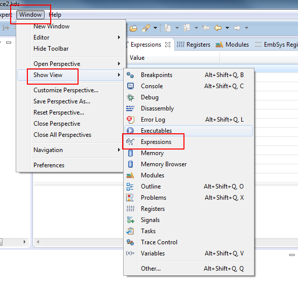

Hello Jimmy,
If you want check the global variable , please use the "Expression" view:
Window -> show view -> Expressions
Hope it helps
Alice

This is a known bug in Eclipse (Bug 219040 – [variables][cdi] Variables view should show globals (or should it?) )
The workaround is to add the global variable to the Expressions view.
