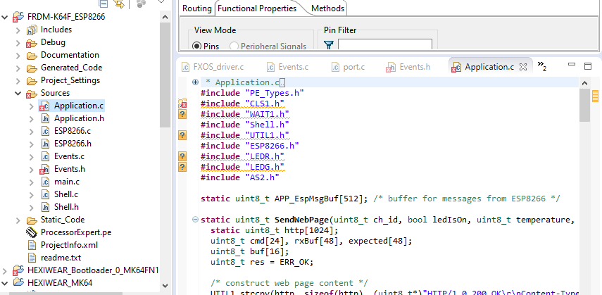

markjvillamor
Hi Erich,
I have imported the ESP8266 KDS file into my main hexiwear file and these were the errors that showed. I am not sure how to edit the CLS1.h and the rest of the header files using processor expert. Would like to ask for guidance, thank you.
Mark

Omar_Anguiano
Hello Mark Villamor
This post may be useful Tutorial: Web Server with the ESP8266 WiFi Module | MCU on Eclipse  Although this post is for a KL the steps are very similar to the K64
For a detailed guide of how to use processor expert I suggest you this post: Tutorial: Blinky with Kinetis SDK V1.3 and Processor Expert | MCU on Eclipse
And the processor expert user guide: http://cache.freescale.com/files/soft_dev_tools/doc/user_guide/QCSPEXUG.pdf
Let me know if this is helpful, if you have more questions do not hesitate to ask me.
Omar

markjvillamor
Hi Omar,
Another issue that confuses me is how do I interface the ESP8266 with Hexiwear. It is true that Hexiwear uses MK64 MCU and I have tried using processor expert to change the pin configurations of the ESP8266 by following the tutorial you provided.
I used a separate provided source code FDRM-K64F_ESP8266 from github and I tried configuring the pins to UART3 successfully. I also managed to build it without any errors. However, when I copy these files into my Hexiwear_MK64 source code files to run them I would encounter errors. I am not entirely sure how to interface the given ESP8266 code into my given Hexiwear code. It would be helpful if you could guide me with this.
Thank you.
Mark
4,020 Views
markjvillamor
Hello Omar,
Is the configurations for Hexiwear and K64 just the same? I am aware that Hexiwear is also using K64 mcu and therefore share similarities however when I run the ESP8266 driver in the hexiwear it shows error that I assume are pin configurations for a K64 module instead of Hexiwear. That part is what confuses me.
Thank you.
Mark
