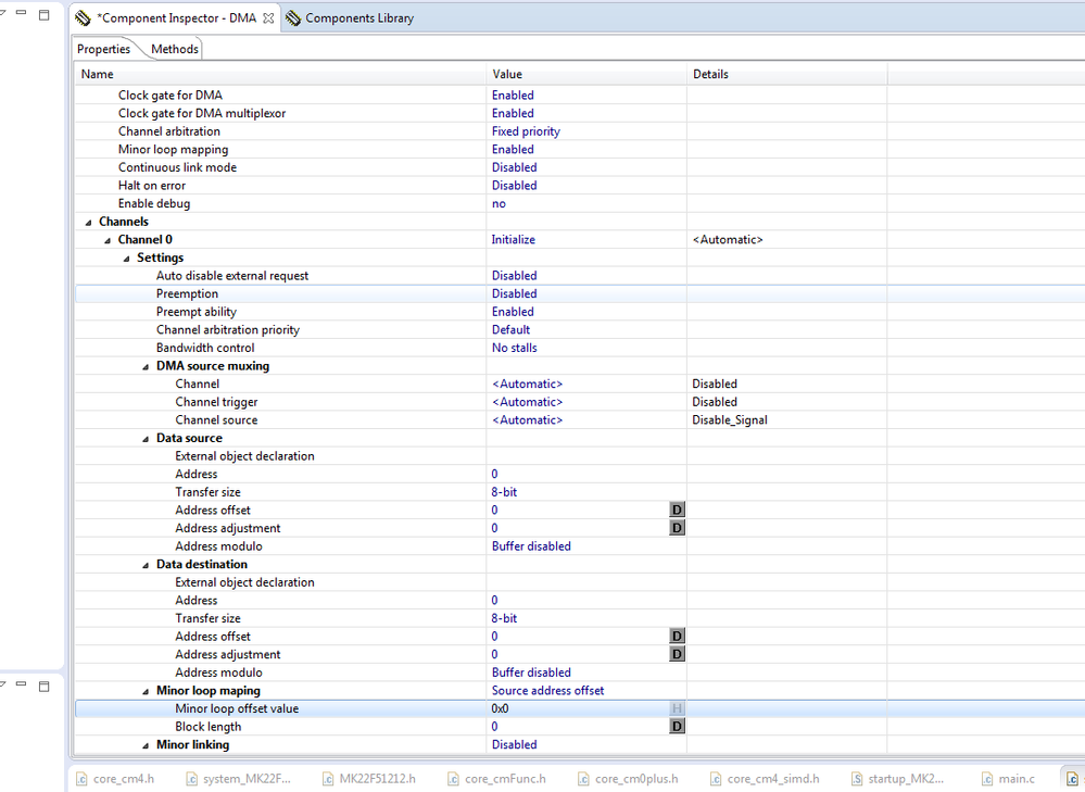

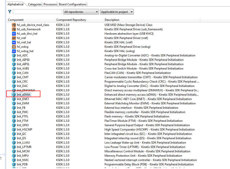

Please select the component of "Init_eDMA":
then you can see the configure information about the dma registers , for example the minor/major loop of the eDMA component .
Hope it helps
