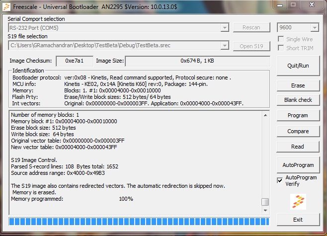

Hi I am using MKE02Z64VLD2 microcontroller in KDS 2.0 IDE.. For me memory is getting Erased and Programmed perfectly.
My application code name is TestBeta which is a simple code to blink LED. I converted this Application file into S19 file and I included it under s19 file section.

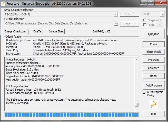

Memory is Erased
Memory is programmed
But the LED is not blinking.
What is the problem ?

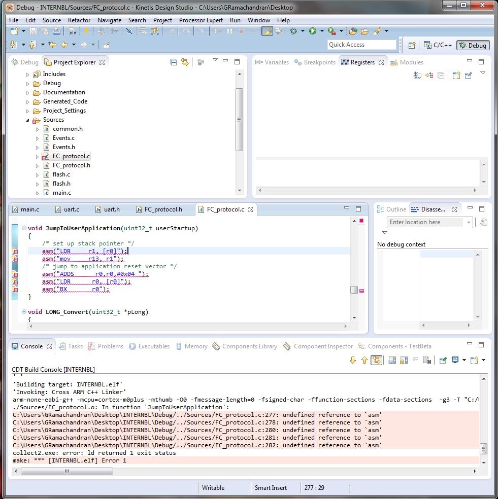

Hi Ganesh,
Please try this :
void JumpToUserApplication(uint32_t userStartup)
        __asm("ldr r1, [r0,#0]");      //get the stack pointer value from the program's reset vector
        __asm("mov sp, r1");          //copy the value to the stack pointer
        __asm("ldr r0, [r0,#4]");      //get the program counter value from the program's reset vector
        __asm("blx r0");          //jump to the start address
Alice

ganeshramachand
Because it threw me these errors. Can you help me fixing it ?

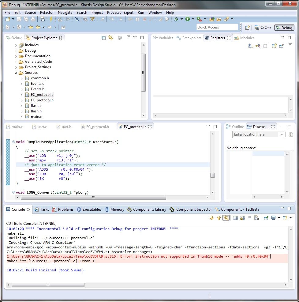

Please change to this :
    // set up stack pointer
    __asm("LDR    r1, [r0]");
    __asm("mov    r13, r1");
    /* jump to application reset vector */
    __asm("ADDS      r0,r0,#0x04 ");
    __asm("LDR      r0, [r0]");
    __asm("BX      r0");
This is the jump function , it can not jump to your APP without these code .
If there is anything else you also mask , please tell me our change it by yourself .
Alice

ganeshramachand
It throws me this error. Error: instruction not supported in Thumb16 mode -- `adds r0,r0,#0x04'
What should be done ?

Step 7: I pressed the Erase button then I pressed the Program button as shown in the screenshots above (in my question).
Step 8: What should I do to make the APPLICATION CODE run ?
I am stuck at this step...

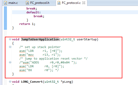

Hello Ganesh,
In you bootlader code,  the RELOCATION_VERTOR_ADDR is 0x1000,
while in the application project ,the start address is 0x4000, so it can not jump to the right place ,
then the application can not work well .
Please change RELOCATION_VERTOR_ADDR to 0x4000.
Hope it helps
Alice
5,091 Views
ganeshramachand
Hi Mam,
Thanks for the Help. I changed it and I am getting the same problem. I mailed you the code again. Please help me with this. And If possible can you send me the screenshots of how to run the application code in the Boot loader GUI ?
When I press the Program button in Boot loader GUI, the application code should run right ? in my case, when I press the Program button, the LED should blink right ?
5,091 Views
OH, why the application of "JumpToUserApplication" is empty :
