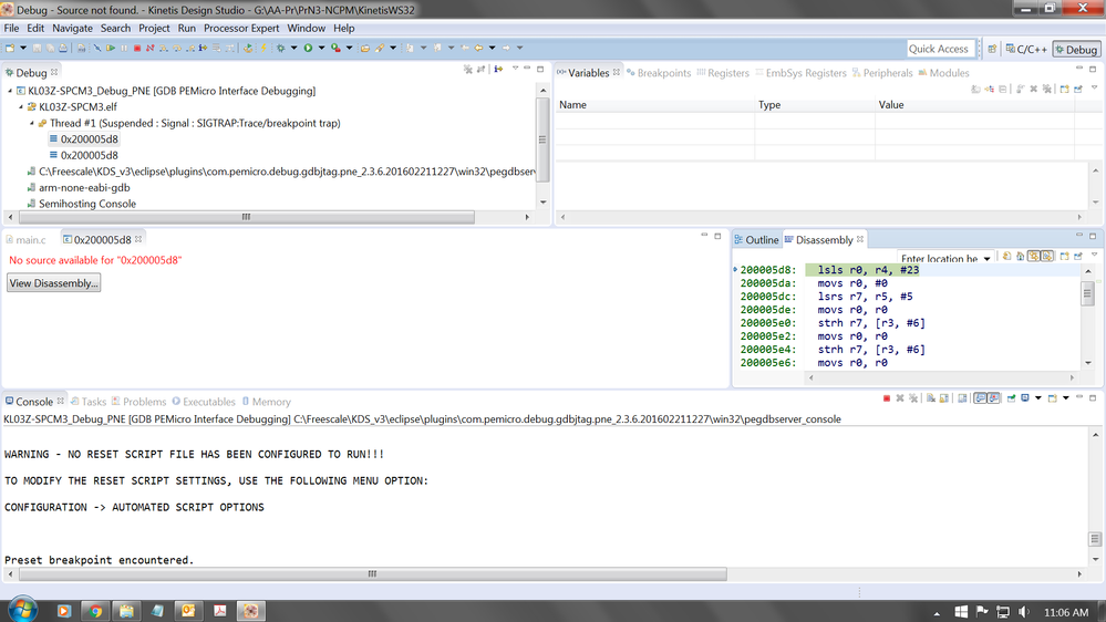

In new installs of KDS 3.1 or 3.2, when initiating debug mode for an existing project, I get a warning at the end as follows:
"WARNING - NO RESET SCRIPT FILE HAS BEEN CONFIGURED TO RUN!!!
TO MODIFY THE RESET SCRIPT SETTINGS, USE THE FOLLOWING MENU OPTION:
CONFIGURATION -> AUTOMATED SCRIPT OPTIONS"
This warning seems to be associated with the debug mode not operating properly.  I can't find where the "reset script settings" are configured (the menu option "CONFIGURATION -> AUTOMATED SCRIPT OPTIONS" does not appear to exist). Please comment how to resolve that warning.  Thanks in advance.

To investigate the problem efficiently, can you please upload the screenshots of the error messages?

Greetings Jennie:
Thanks for your help with this.  Per your request, I have attached a screenshot.  The screenshot is after the target is run after it automatically stopped at the preset breakpoint at the beginning of the program.  The "WARNING - NO RESET SCRIPT FILE ..." note at the bottom was present at the preset breakpoint (at the beginning of the debug session).

BlackNight
Hi Thomas,
as notted, that warning comes from the latest P&E GDB server implementation. I don't know how to disable that warning (I have asked them). I do have that warning too, but on my side it does not affect operation: I can debug the FRDM-KL03Z and KDS V3.2.0.
