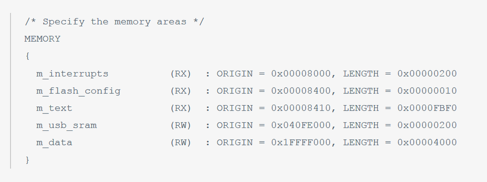

I also created a blinky-8000 project, where the *only* difference is that I modified the memory map to offset each section by 0x8000, so my MKL27Z64xxx4_flash.ld file contains:
/* Specify the memory areas */
MEMORY
  m_interrupts          (RX)  : ORIGIN = 0x00008000, LENGTH = 0x00000200
  m_flash_config        (RX)  : ORIGIN = 0x00008400, LENGTH = 0x00000010
  m_text                (RX)  : ORIGIN = 0x00008410, LENGTH = 0x0000FBF0
  m_usb_sram            (RW)  : ORIGIN = 0x040FE000, LENGTH = 0x00000200
  m_data                (RW)  : ORIGIN = 0x1FFFF000, LENGTH = 0x00004000
When I load this via the Segger J-Link and attempt to run it, it ends up running the original blinky-0000 code.  And it doesn't know how to find the source code associated with the current PC, which isn't surprising since it's running at the "low" pc values.

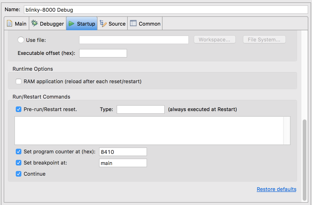

In the Debug Configurations, I set ["Set program counter at (hex):] to 8410, but that didn't seem have any effect.  (I also tried setting the [Executable offset (hex):] to 8000, but that had no apparent effect either.)

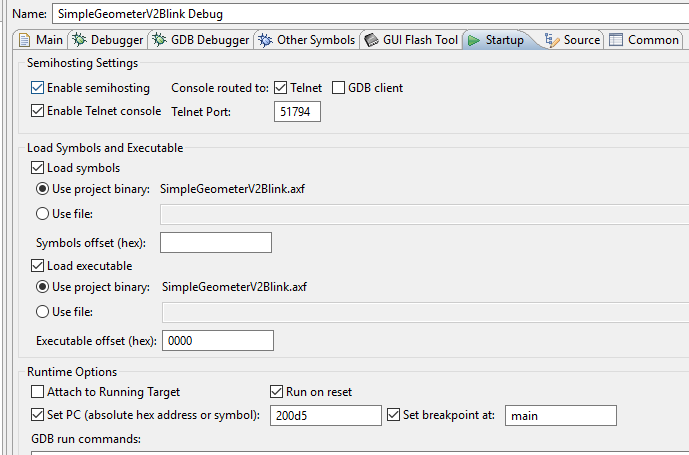

Have you tried this on MCUXpresso? I'm fighting the same thing (and have for months) with KL46z. I don't know how to move just the interrupts to 0x00 in MCUXpresso as you did.

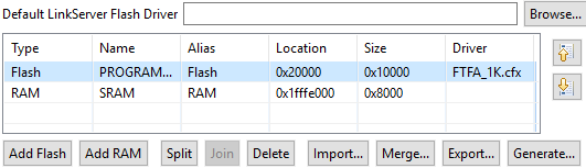

My plan was to use a ready bootloader like MCUBOOT but I never got it right (the KL46z is not supported in the package so I tried to build it myself). I have managed to make a bootloader and to my best knowledge the code is written correct in the flash. For simplicity the bootloder is in the lower 128k and application in the upper 128k - this way there is not a problem with writing to flash (later I must learn to do this from RAM so that I dont wate all this memory space). But when running the program something goes wrong - and in spite posts saying that the debug information should be possible to get - I have not managed that. My blink application runs fine from 0x00. I would now try to debug-run my code at the offset address of 0x20000 but this fails when the address is as follows:
and the debug configuration startup as follows
(also tried executable offset of 20000). 200d5 is the second 32-bit number in my flash s19 file (the PC).
A strange thing happened. I had newly run the bootloader application so the vectors at 0x00 where filled in. In this case the configuration above ran my application. But when I erased the flash and programmed my application again - it did not work. Somehow I think MCUXpresso does not move the VTOR to 0x20000 even when the offset is set to 0x20000.
I wold be happy for any comment.

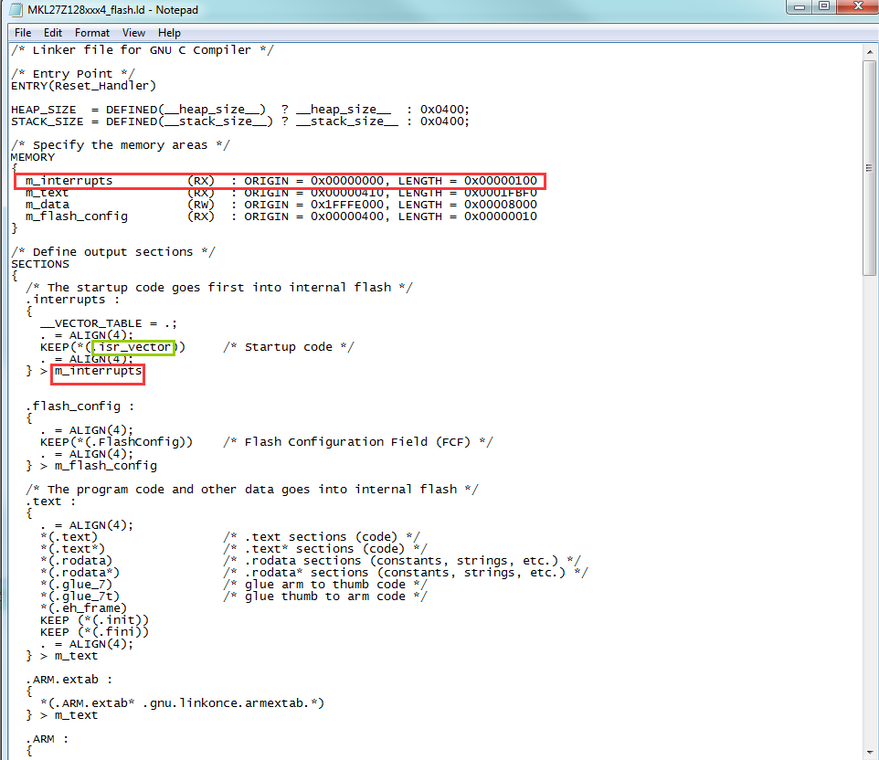

- There is a DOC about linker Command filer for CodeWarrior, while you refer to it to analyse .ld file on KDS.
https://cache.nxp.com/docs/en/application-note/AN4498.pdf?fsrch=1&sr=1&pageNum=1

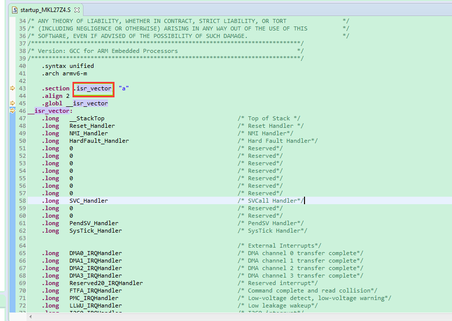

-For the m_interrupts as example, please check the below, it save the .isr_vector part,
then search it on your project,
so the the interrupt vectors are placed into m_interrupts .
Other parts is the same. So if you want to relocate the whole m_text, yes, you are right, only need
configure the m_text address.
