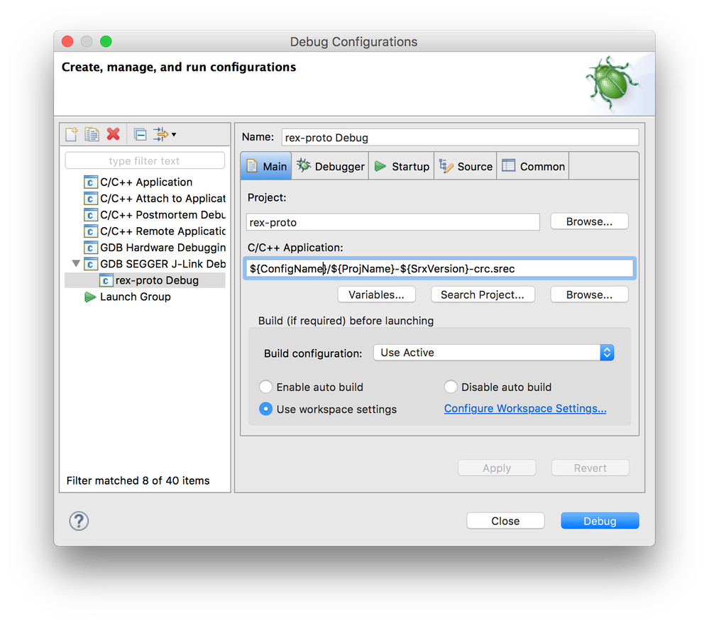

Update: Wait a minute!  I thought I'd be able to insert Build Variables into the Debug Configurations dialog in order to control the C/C++ application that it looks for:
... but clearly that's not the case.  Let me add a follow-on question: How do I tell the debugger to load the C/C++ application with the filename and version #?  Is there a way to expand a Build Variable in the Debug Configurations dialog?

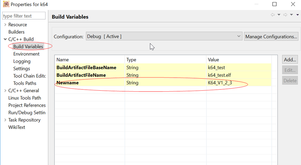

Hello Robert,
Sorry I don't really know your meaning , do you want to rename file with version number ?
If yes, how about the post-build commend:
- Add Build Variable"Newname":
- In Post-build, input command:
- Build , the new name with version number appeares:
