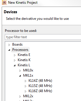

Hello there!
I'm new to ARM/Kinetis/KDS and actually having difficulties to add support for KL1x (KL17), uC in Processor Expert:
- I have installed KDS 3.2.0 straight from the installation file (no updates).
- I try creating a new Processor Expert Project but KL17 is not listed among options (just KL14Z, KL15Z & KL16Z are available)
- I browse Processor Expert Software, Microcontroller Driver |NXP And page says that Kinetis L series is supported.
- I click DOWNLOAD button and in the opening page:
      - I dont need installing "PEx-KINETIS-v3.0-PLUGIN-ECLIPSE_3.7-4.3 (REV 3.0.0)", it's already installed when I installed          KDS, that's right?
- In "Updates and Patches" I download "Processor Expert® for Kinetis® v3.0.2 update (REV 3.0.2)"
      - Now I'm bit confused about versions: I see the plugin 3.7-4.3 (REV 3.0.0) - although i didn't installed it - but a update          v3.0.2 (REV 3.0.2). Anyway:
- In KDS under Help->Install New Software->Add->Archive *select the downloaded update zip* (PEx_for_Kinetis_3.0.2.zip).
- The package show in the windows I can select it but "Next" is grayed out. See picture below. I tried restarting KDS. It    works for other packages from the default internet links.
What is the correct procedure to have KL17 support in KDS PEx?
Thanks!
Rodrigo

Hi Rodrigo.
for KL17, KDS only supports processor expert with KSDK1.x.
see attached video.

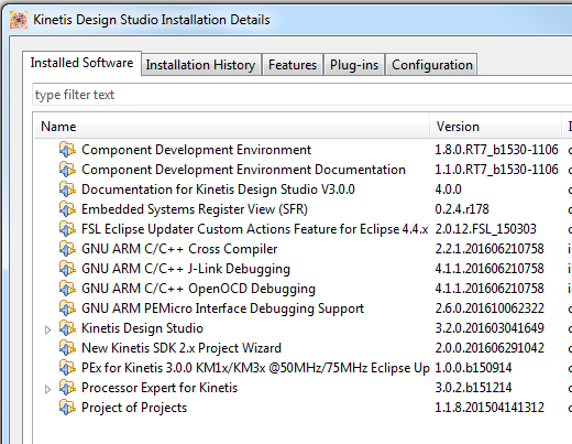

stevescott
I have the same problem. I cannot see the KL17Z processor in the list of processors:
How did you get the KL17Z to show up?
Here are the KDS installation details:
1,187 Views
rodrigon_hernan
Hi Steve,
Do the following:
1- Go to Welcome to Kinetis Expert | Kinetis Expert click "Build an SDK"
2- Create the device "MKL17Z256xxx4". In the dropdown menus under "Your custom version of the Kinetis SDK is now       ready to be packaged! Click the button below to complete the process" part choose "SDK Version = 1.3" & "Supported       toolchain(s) = Kinetis Design Studio", change the field "Package name" to "SDK_1.3_MKL17Z256xxx4" and finally "Build       SDK Package".
3- Once the package becomes available under "Software Vault", download it, create a folder and extract all files.
4- Open Design Studio and go to Help->Install New Software. Click "Add"->Archive, then browse to the file under the folder you extracted the SDK files:"YourSDKFolder\tools\eclipse_update\KSDK_1.3.0_MKL17Z256xxx4_1.0.0_Eclipse_update.zip"
5- Mark the checkbox with the update, click Next/Finish/Install
You should be done after doing this.

rodrigon_hernan
Well, now I see it: PEx 3.0.2 is already installed so that's why I'm getting a greyed out "Next" right there.
But then, why KL17Z is not listed? I'm just out of luck with PEx for KL17Z for now? Any clue about how to get it going?
