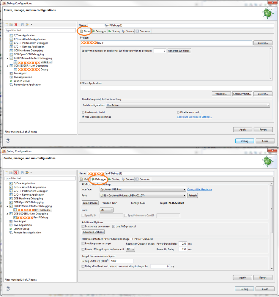

meiso
Hi Ben,
Yes, all the software needed for the cyclone universal are installed, all these software were acquired directly from PEmicro.
I am able to see the device on the "debug configuration" from KDS(see attched picture), and I am able to debug the code with a J-link without problem.
2,033 次查看
johnny_pe
Enlai,
I would load a new project for your MCU. Then check if it is possible to debug the MCU and set breakpoints with the Cyclone. If it works fine in a new project, then the issue is likely to be an improperly configured debug configuration in your project. This is what I suspect but would like some confirmation.
You can create a new KDS project for your MCU with the NXP SDK builder site.
Welcome | MCUXpresso SDK Builder
Since stand alone programming works fine, it sounds like you have no hardware or connection issues.
