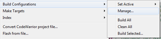

Hi averyone!
I would like to know which are the basic steps in order to build a release configuration for a targe in Kinteis Design Studio 3.0
Thanks!
1,992 Views
BlackNight
Right click on the project and use Bulid Configurations > Manage:
Then you can add/delete/manage build configurations.
