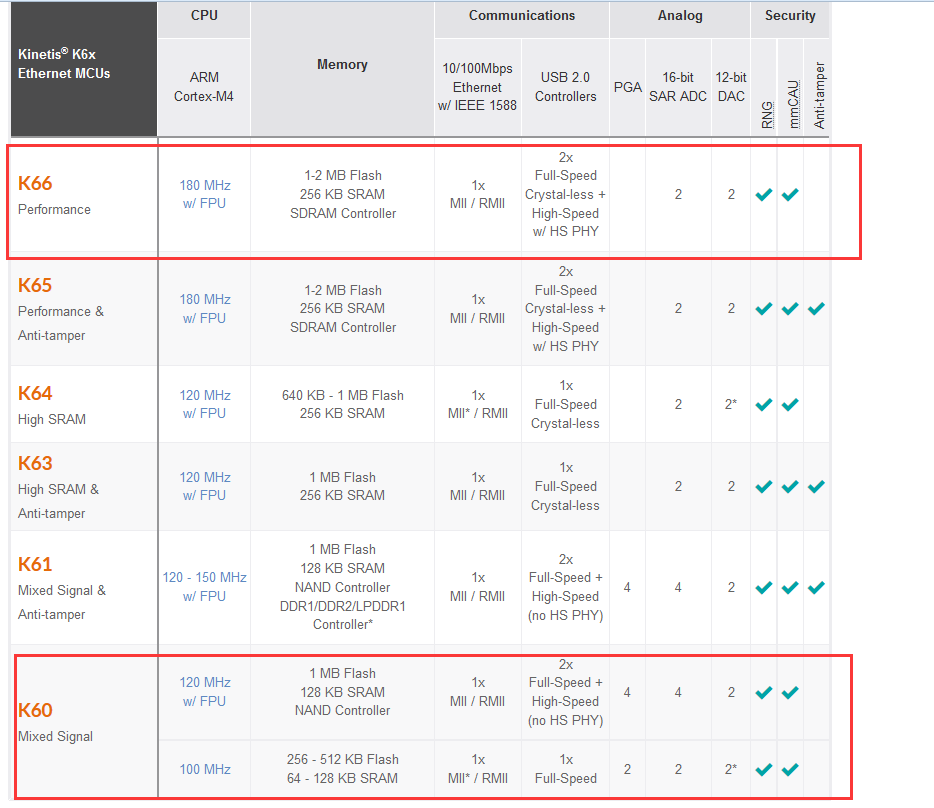

If the modules usage are same for K60 and K66 is there a way of making condition compile the projects K60 and K66?
Is there any example project?
Start up code and device headers are different, anything else?

Hello SIVA,
There are  some difference  between the two boards :
I recommend you create a project about K66 on KDS, then copy the application code from K60 to K66.
And check whether there is difference about the parts it used on Reference Manual .
Hope it helps
