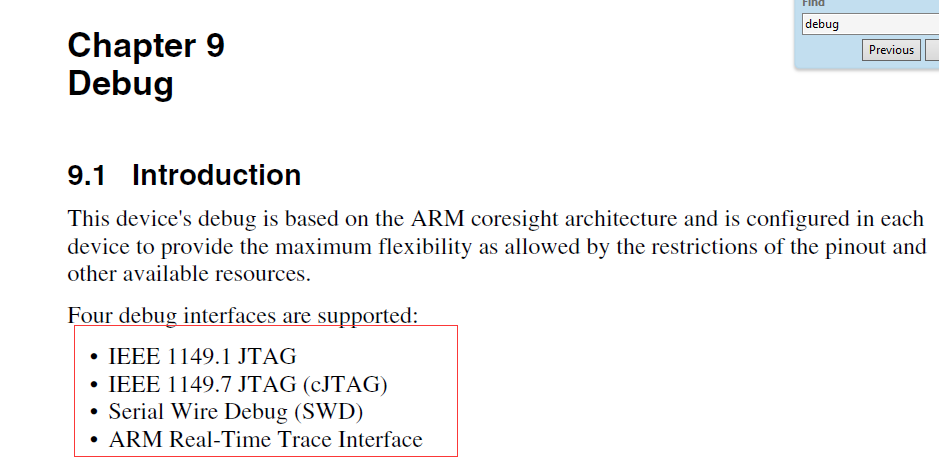

Does MK22FX512AVLQ12 supported the JTAG only?  (so not support the SWD interface).

Hello kobayashi,
The Kineits k series MCU support JTAG and SWD debug port .
So the chip of MK22FX512AVLQ12 support bot JTAG and SWD.
Please check the reference manual of this chip :

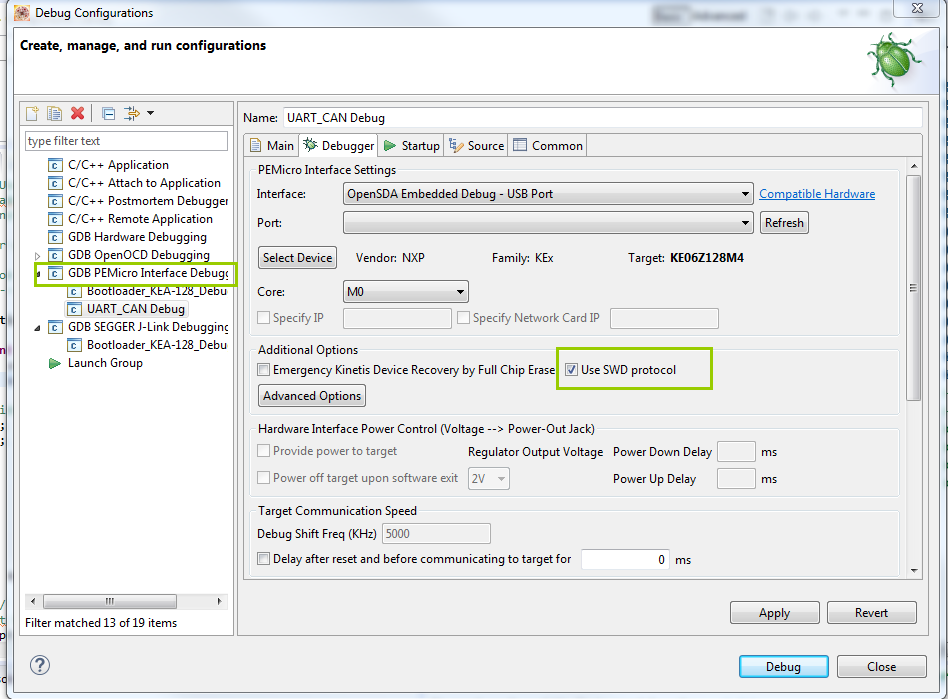

Hello Kobayashi,
- On KDS, you can select the SWD protocol :
- About the hardware connection , you can refer to the FRDM-K22 board , or you can ask in the Kinetis Microcontrollers part :  https://community.nxp.com/community/kinetis

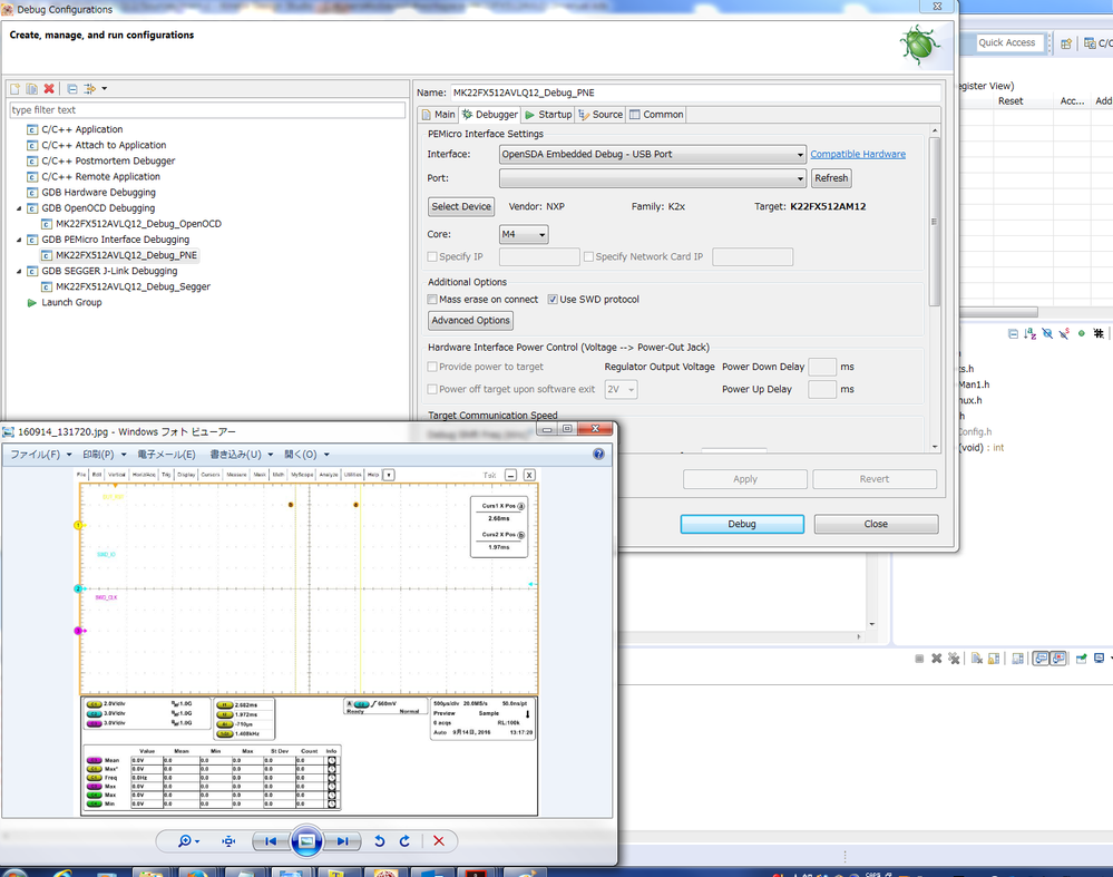

I tried your suggestion.
I clicked the "Debug", SWD waveform did not appear  when SWD_IO pin was setting the trigger of rising edge.
I think, that GDB PEMicro Interface Debugging is selected when the ICE of the P&E Universal Multilink is used.

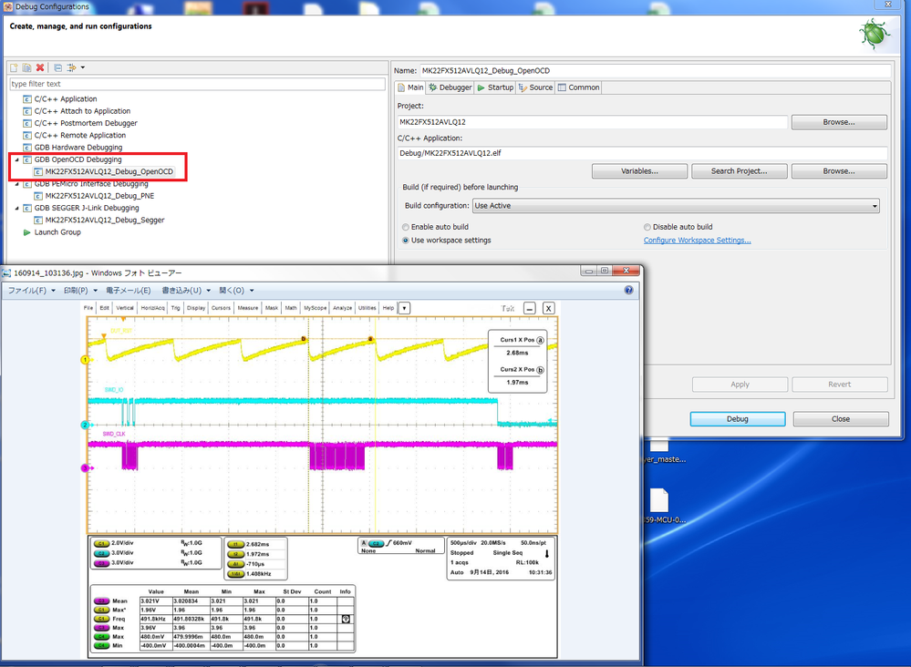

I used the OpenSDA of  FRDM-K22F. Therefore GDB OpenOCD Debugging was selected.
SWD waveforms were as following.( Yellow waveform is Reset_b pin. Blue waveform is SWD_IO pin.
 Purple waveform is SWD_CLK pin.)
SWD pins configuration was as following.
SWD_IO and SWD_CLK waveform appeared.
But  Reset_b signal was oscillating. Then not enter debug mode. So not programming into the FLASH memory.

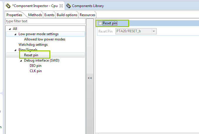

How to stop  the Reset_b oscillating by KDS?

Hello Kobayashi,
- About disable the Reset_b pin, you can uncheck the "Reset_pin"
