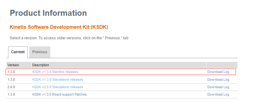

I have installed Kinetis Design Studio 3 IDE. When I create a new Processor Expert Project, the Processors do not include MKW3x and MKW4x. So I want to know how to add them in KDS? Thank you!

Hello Lingxing,
If you want use the product of KW3x and KW3x , please download and install KSDK1.3,
about the download and install please refer to the doc of "KDS_Users_Guide.pdf"
(it under the KDS install directory : KDS_3.0.0\doc)
You can download it at here :
https://nxp.flexnetoperations.com/control/frse/product?entitlementId=123594587&lineNum=1&authContact...
After install it , restart KDS .
Hope it helps
Alice

lingxingthu
Thank you for your help, Alice. I have solved the problem with your method.
