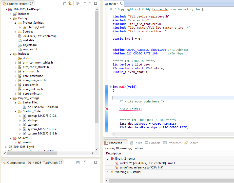

I'm coming from the land of visual studio and Ipython, so Eclipse is very foreign to me. So, I've been through this tutorial to attempt to create a blank C project for my FRDM-K22 Board, because no other way I was doing has proved successful: Tutorial: DIY Kinetis SDK Project with Eclipse – Startup | MCU on Eclipse
And still no dice.
I had the idea to copying an example project as a template, but that leads to more errors than trying to create one from scratch.
Here is what I have done:
1)SDK is installed, and I have imported ksdk_platform_lib_K22F51212 and built within the project.
2)I build a new C project and provide KSDK linking along with some other things in the preprocessor, such as ARM_MATH_CM4.
3)By default the OSA and Utilities folder are not showing up, so I add them in includes.
I can tell from syntax highlighting that the libraries are there, and it recognizes my includes like "fsl_os_abstraction.h" as valid, along with data structures, and various other things that could only come from the SDK.
The minute I add any actual functions from the SDK like "OSA_Init()", it gives me an undefined reference to "insert function name here."
I've looked very hard at the examples (particularly the DSPI example)  then  try to find differences in my setup, or linking, but I can't find them, nor get it to compile successfully.
Thoughts?

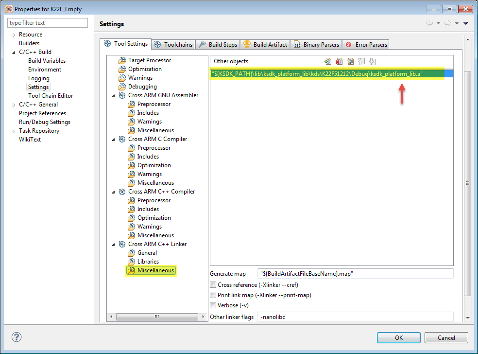

Hello Donald:
I am sorry to know you have been struggling.
I think you are just missing to include the compiled library in your K22 KSDK project, in Project -> Properties -> C/C++ Build -> Settings -> Cross ARM C++ Linker -> Miscellaneous:
So the errors should be gone.
For further reference you can check K22 SDK User's Guide in your KSDK installation:
C:\Freescale\KSDK_1.0.0\doc\Kinetis SDK K22 User's Guide.pdf
And also, the next good tutorial by coleague Carlos Musich:
https://community.freescale.com/docs/DOC-102612
This is a step-by-step tutorial to create a KSDK project, and mentions the thing about adding the library, which I think you missed.
Regards!,
Jorge Gonzalez

bosleymusic_com

bosleymusic_com
I had done this in an earlier iteration of trying settings, but I think I put the link in the wrong spot.
Lifesaver, I'm sitting here writing drivers based on HAL...so much time will be saved!
Thanks.
