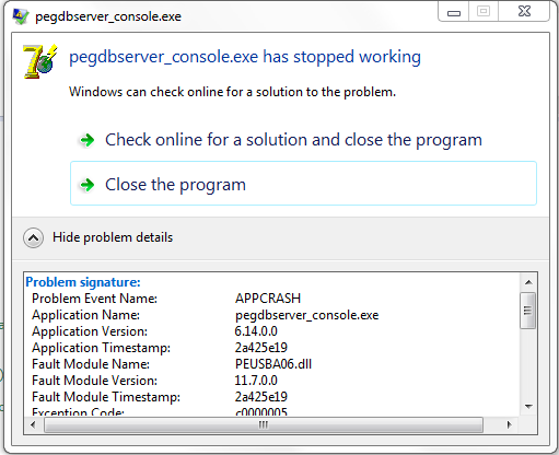

kenholt
I get this error at the debugger startup in KDS 3.2 and KDS 2.0.
I am using Windows 7 and FRDM KL46Z.
I have read the similar questions here in the forum, and checked some things.
I have no zombie or ghost processes.
The debugger was working fine recently in KDS 2.0, but I recently installed 3.2 as well.
Must I re-install all of my KDS's to try to get past this problem?
Any suggestions would be appreciated.
Ken H.

kenholt
Hi Erich - thanks for your suggestions. I did disable the firewall, but so far, no help.
The error always occurs immediately after opening the debugger, whether or not the development board is connected.
Also, I have uninstalled the KDS 3.0, with no change. ( I haven't tried re-installing that one yet.)
The proximal cause of the problem may be when I had ver 3.2 and 2.0 both open at the same time, while I was trying to configure the 3.2 debugger for the first time. Could a resource conflict have caused the problem? I think that my Windows Home Premium is not very robust in some circumstances.
Someone suggested that I open KDS with a different user name. Or upgrade to Professional, or get a Macbook?
Thanks again,
Ken H

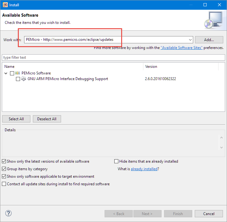

BlackNight
Hi Ken,
have you already updated the P&E plugins with Help > Install New Software?
I hope this helps,
Erich
