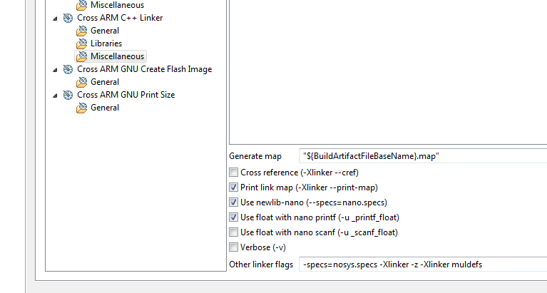

But the optin nanolib :
has no affect on printf() function.

My question is,
Exist something similar as CR_PRINTF_CHAR for libreries in KDS 3.2 ?

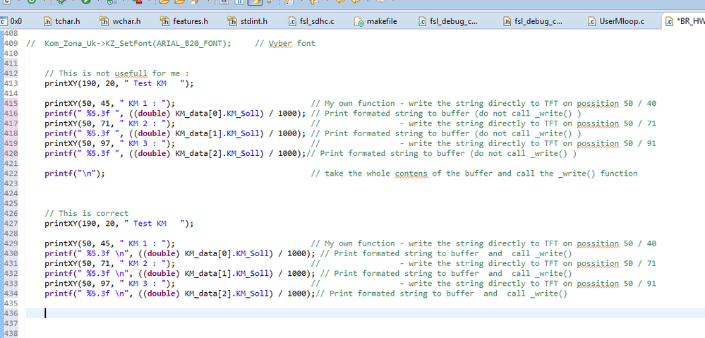

Hi Alice, thank for Your response,
I know this possibility, PRINTF() is defined as  DbgConsole_Printf()  (if SDK_DEBUGCONSOLE)
or as printf().
I 'm using printf, with my own functin _write() witch puts the charakters on the TFT.
printf() is putting charakters into buffer (on the heap) untill
"\n" is present. It works as in your example.
But
a)  I have a lot of code (written fo CodeWarrior and MQX) where I use something as:
the printXY() is my functin for printing unformated string directly to the position X,Y on the TFT.
Problem in this case is, that there are no "\n" in printf() functions and the strings from all printf() functions
is outputted when the internal buffer (0x400 long) is full (or on first "\n").
But the printXY() function outputs the string imediately.
I can solve this problem when i'll insert "\n" into every printf() (its plenty of code).
b) it occupies memory on heap, unnecessarily and needless
   my _write() function puts the characters to its own buffer.
I know, that in SDK 1.3 is some option (I cant find that file just now) how to say to prinf() function to do not use the buffer.
Especially for processors with small memory.
I cant find similar optin in SDK 2.0.
And there is my question, exist some option in KDS3.2 /SDK2.0 how to say to printf() do not use the bufffer
and call _write() function for every character?
