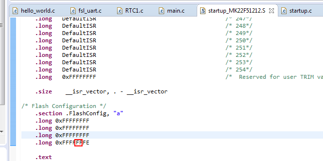

I have been programming with Freedom kl25z on KDS and sdk 2.0 with FREERTOS, and now I have some problem when I try to use the GPIO PTA4 because this pin is using by NMI, and then I would like to know how could disable the NMI from SDK 2.0 FreeRTOS withou

If you want disalbe the NMI interrupt, please use the Flash Option Register (FTFA_FOPT) ->
NMI_DIS bit :
On the KSDk project code ,, only need change here :
to
  .long 0xFFFFFFFF
    .long 0xFFFFFFFF
    .long 0xFFFFFFFF
    .long 0xFFFFFBFE
Hope it helps
