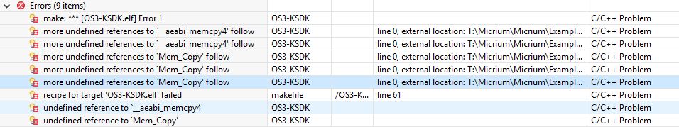

I tried importing everything as manually as possible inside KDS, and I followed again the guide you linked to me, adding the lib name, lib path and all the needed .h files. I also checked if all the needed files are there, and they should be there.
However, the library is correctly recognized, but I'm still getting these errors, that seems to come directly from inside the .a library:
Mem_Copy is by the way defined, and inside IAR in fact everything compiles correctly.
Why am I not able to use the very same library inside KDS?

es483
Thank you very much for your reply!
I just found out that this error was probably happening because most .c files are in fact packed inside a pre-compiled ".a" library, and so, without including it, the function were only present in the .h files, thus the "undefined reference" errors.
I tried importing it, but I get some "most undefinded references to xxxxxxx follow" errors coming from the external library! I fear these errors come from the fact that this library has been generated for the IAR compiler, not for GCC.
In the IAR project there's also a IAR compiler specific .asm file, that I cannot import in KDS... so... I think more research has to be done in order to understand if it possibile to use this in KDS... or not!

Hello Francesco Raviglione,
- I haven't use the KDS on uC-OS , I think its the same.
On KDS, if you want use the .a lib , you only need refer to the guide I mentioned last time to do it.
Add the lib name , lib path, also the .h path.
- About the compiler problem,  I recommend you create a new blank project on KDS, then add the lib , copy application codes . Or it hard to solve problem.
