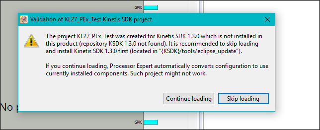

First, I tried upgrading the SDK from 1.2 to 1.3, This effort rendered my entire Design Studio inoperative.  I then did a clean install of KDS3.0, then applied the updates and then installed KSDK1.3.  I then created a quick Processor Expert project.  Project created OK, however, it had errors.  I closed  and reopen Design Studio and get the following error message.
How is this possible?  Any help is appreciated.

Michael,
it seems you do not have components for KSDK1.3 installed in KDS. You need to apply Eclipse update from KSDK 1.3 directory into KDS to enable configuration of KSDK1.3:
- main menu - Install New Software
- Add - Archive - and select C:/Freescale/KSDK_1.3.0/tools/eclipse_update/KSDK_1.3.0_Eclipse_Update.zip
- Select and confirm installation
Marek

Under Project->Properties check Resource->Linked Resources->PROJECT_KSDK_PATH and C/C++ Build_>Build Variables->PROJECT_KSDK_PATH and see if they point to the appropriate folder location. (wherever the ksdk was installed)
