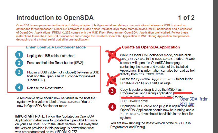

Hello Robert,
- Sorry i have not the Mac, While i think KDS can with KSDK demo can work well on it.
Please refer to the Quick start Guide update the OpenSDA firmware, first enter OpenSDA
Bootloader mode, then copy and paste the "14_OpenSDA_FRDM-KL27Z.bin" into it, Unplug the USB cable and plug it in again .

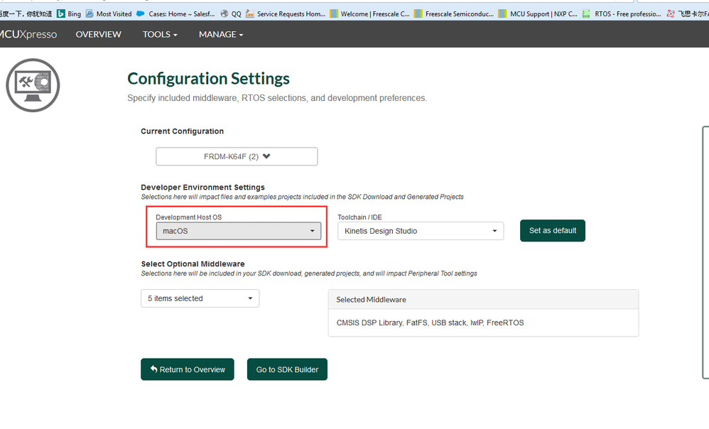

- Please pay attention , when you download KSDK, select the MAC OS version :
Hope it helps
