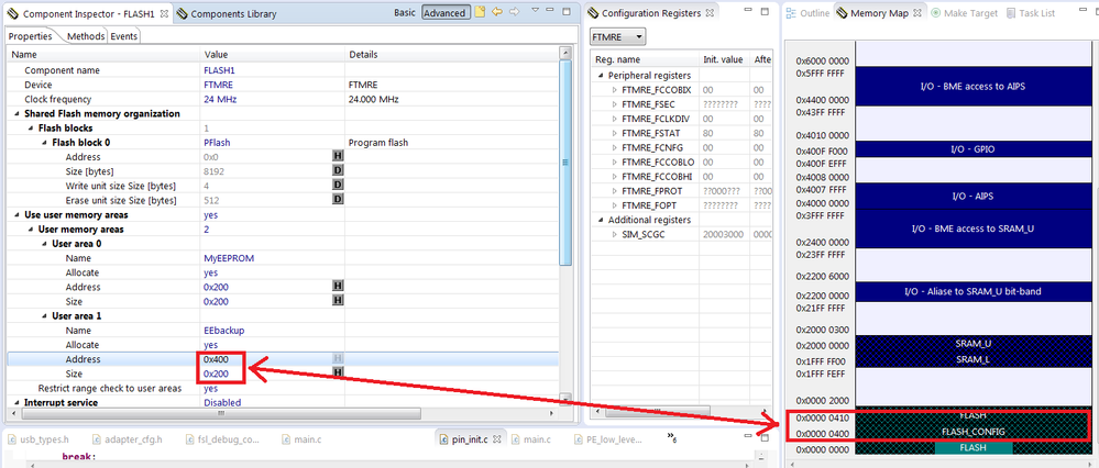

I'm trying to emulate an EEPROM in Kinetis KE04Z8VTG4. Now, I'm using FLASH_LDD component with success, in fact I'm able to write and read data without problems.
When I build the project an errors message occurs "Generator: FAILURE: Unexpected status of script: Drivers\Kinetis\Kinetis_FlashConfig.prg, please contact Freescale support.", but the build procedure is successful and I can run/debug the code.
So, why that problem?

I verified your project in KDS 3.0.0 and I found out the issue that cause the error. The FLASH1:FLASH_LDD component contains User memory area 1 that overlap the FLASH_CONFIG area (0x400 - 0x410), see the following screenshot:
You cannot use the FLASH_CONFIG area for your user data.
When you set the Address to 0x400 and the Size to 0x1F0 (in the User area 1 of the FLASH1 component) and generate Processor Expert code the error will be cleared in the Problems view.
Please, fix this issue in your project and your project will work properly.
I will report the issue to the Processor Expert development team (a proper error shall be reported in this case) .
