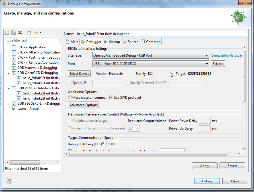

Hi Ivan,
Did a re-boot help?
Did you select the GDB OpenOCD Debugging->hello_frdmk22f int flash debug cmsisdap project to debug?
I just loaded the example and was able to successfully have hello world work for me.
Attached is my MBED firmware ZIPed.
David

DavidS
Hi Ivan,
The firmware I uploaded was from a training class I did last year so just happened to have it.  Not 100% sure where I got it.
The firmware from MBED web site works for me too.
I can successfully use PEMicro, MBED, and JLink firmware on my Freedom board.
My FRDM-K22F has Rev D on the back side.  Is that what yours is?  Wondering you just have an older board.
But if the firmware I uploaded works for you keep it.
Attached is my PEMicro OpenSDA firmware too.
Note below picture that sometimes you need to make sure the correct debugger settings have been set.
David
