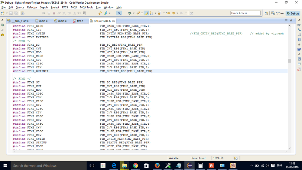

     I want to use FTM1 Channel 1 in KEA-128 But I found that FTM1_OUTINIT which is the register for initializing the output channel in FTM1 doesnot exist.
This is the Screenshot of it.
How to use FTM1 channel 1 if that register is not there???

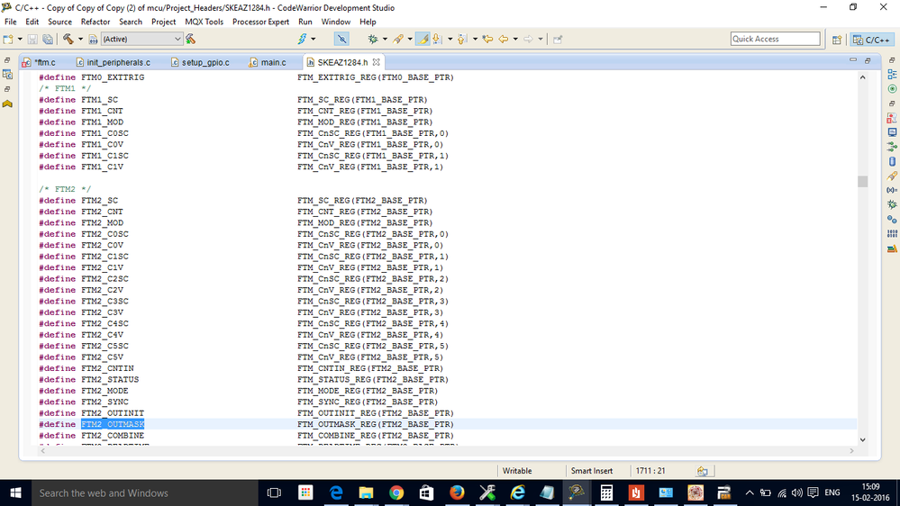

Hello VIGNESH,
For one hand , you can define it by yourself refer to the FTM2_OUTINIT  :
#define FTM1_OUTINIT                       FTM_OUTINIT_REG(FTM1_BASE_PTR)
For other hand you can directly use "FTM_OUTINIT_REG(FTM1_BASE_PTR)".

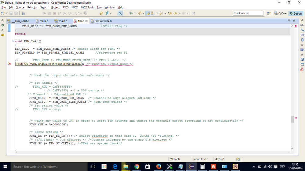

No it didn't work that way.I did it.Please refer the pictures
Eventhough I included FTM1 as you said but it didn't workout.How to fix this?Does FTM1 supports channels???

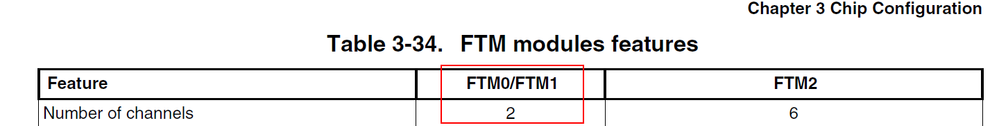

And from the reference manual of the KEA128, we can see the FTM1 have these channel and registers .

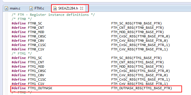

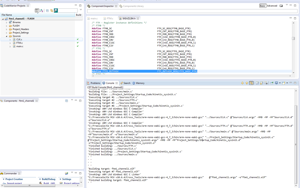

Hello
Please add the macro define
#define FTM1_OUTMASK                       FTM_OUTMASK_REG(FTM1_BASE_PTR)
to the SKEAZ128.h file :
then build , there is no error :
