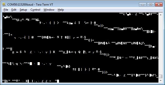

Hi I am doing a project using the FRDM-SFUSION kit with a k64f MCU. I am currently having two problems and am hoping someone can offer some help.
First, I am having problems getting serial data out from the board. When I first plugged it in I opened up a console (using PUTTY) and remember seeing data being fed out through the serial port. Since then I have changed to the Freescale 5.0 Library and added some of my own, though fairly minor, code. The project builds and actually works as expected, so I can't see why my code would mess with the serial output. When I open the console now I only get dots. A professor told me this could mean PUTTY is receiving data that it can't interpret, or that I might have configuration errors with PUTTY itself. I am looking into this to see if there is a problem on my end, but can anyone think of something else that could be going wrong?

In fact, Sensor fusion software does send data using UART drivers through FRDM-K64F's SDA interface (UART0 - PTB16 and PTB17) or UART3 PTC16 and PTC17 (designed to send data to bluetooth module) but this data is "encoded" and Sensor Fusion toolbox is responsible to parse this data, as you can see on next image, I opened a COM terminal with a board with sensor fusion's software and this is what I got:
So, that is why you saw strange data in your terminal. (Sensor fusion does not send data in ASCII format, so we only see symbols in our terminal).
