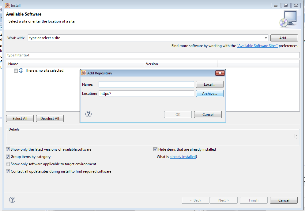

I have installed Kinetis Design Studio V3.2 with Processor Expert.
I see there is no support for KL03, nor for the freedom board.
So I made the SDK using kex.nxp.com,a dn downloaded this.
How can I import this into KDS to be able to make a new Processor Expert project using this device?

What SDK version did you make? Processor expert just support SDK 1.x.
if download this package, make sure that you installed the eclipse update wizard. you can do it with help->Install New Software, click the "Add" button in the upper right corner, then in the Add Repository dialog, select the "Archive" button. Browse the <KSDK install directory>\tools\eclipse_update and select the KSDK_<version>_Eclipse_Update.zip. and install it.

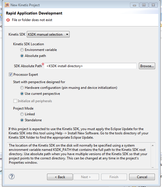

If you already did this, you should be able to create a new project sdk 1.3, select the FRDM-KL03 and in the Rapid application Development options, you should be able to specify the "SDK Absolute path:" after this you could enable processor expert option.
Hope this information help, if not please tell me if you have any problem
