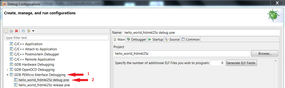

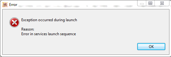

Ever since updating to SDK v2 I have not been able to debug using the GDB PEMicro Interface Debugger. Before updating to SDK v2 I had no issues, now when I try to debug an error occurs stating "Exception occurred during launch. Reason: Error in services launch sequence."  I have ensured that all my software is up to date.

I have this same issue.  I'm using a TWR-K60N512 with Kinetis Design Studio 3.2.0 on Windows 10.  All my software is up-to-date.
It would be helpful if you could let me know what this cryptic error message means.  It basically says "There's been an error because an error occurred."  Not very useful.

that cryptic error message comes back from GDB, and I agree, it is not every helpful. I think this is one of the biggest complains about GDB, but changing GDB unfortunately is not the topic here. Understanding how GDB works can help:
What is causing such an error message is usually some bad arguments or failure of launching the GDB server from the client in Eclipse (see https://mcuoneclipse.com/2015/05/18/gdb-client-and-server-unlocking-gdb/ about that concept). The same article describes one reason and solution for the "error in services launch sequence", so you might check that one. The same message you get if the GDB server cannot be found (I have seen cases where firewall software has removed it because it communicates through TCP/IP), so you should check if the server is still present on your machine.
If that does not help, it would be helpful for me if you could post here your launch configuration files (or screenshots of it), as I think some settings might be wrong. What should work is if you create a new project with File > New > Processor Expert project (you don't need to turn on Processor Expert), as this creates a simple project with working launch configuration settings). If that fails too, then it is not a problem of your project files, it is very likely a problem with the GDB server on your disk, or a problem with your OpenSDA firmware or drivers.

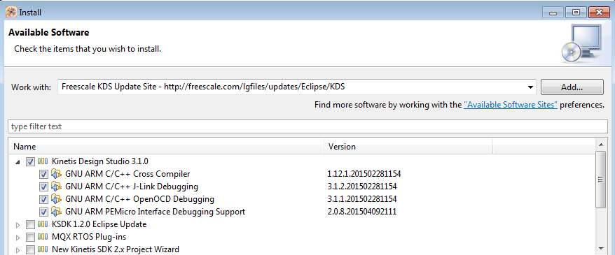

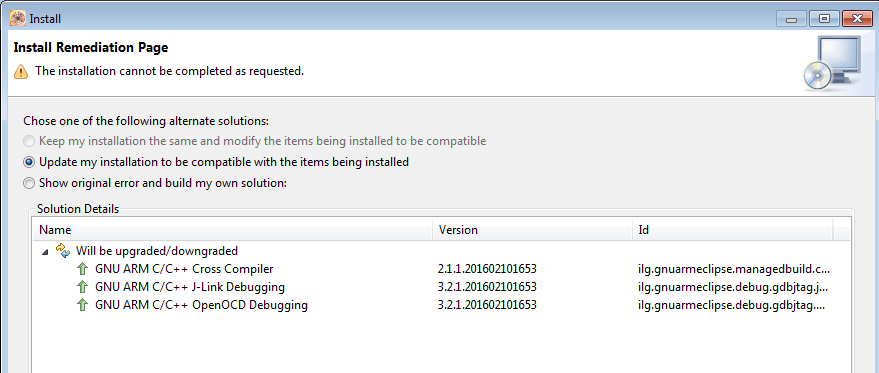

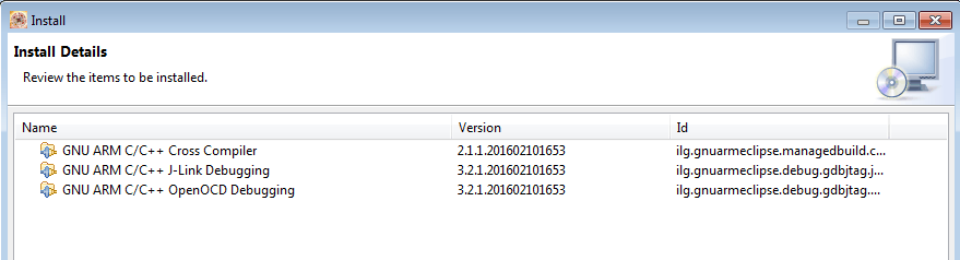

DavidS
Hi Jake,
Did you update the KDS?  I just did the Help->Install new software... and updated the following:
Above pictures of the updates I did.
I just did a test with FRDM-K64F and KSDK_v2 for it using the P&E Micro OpenSDA debugger interface.
David
