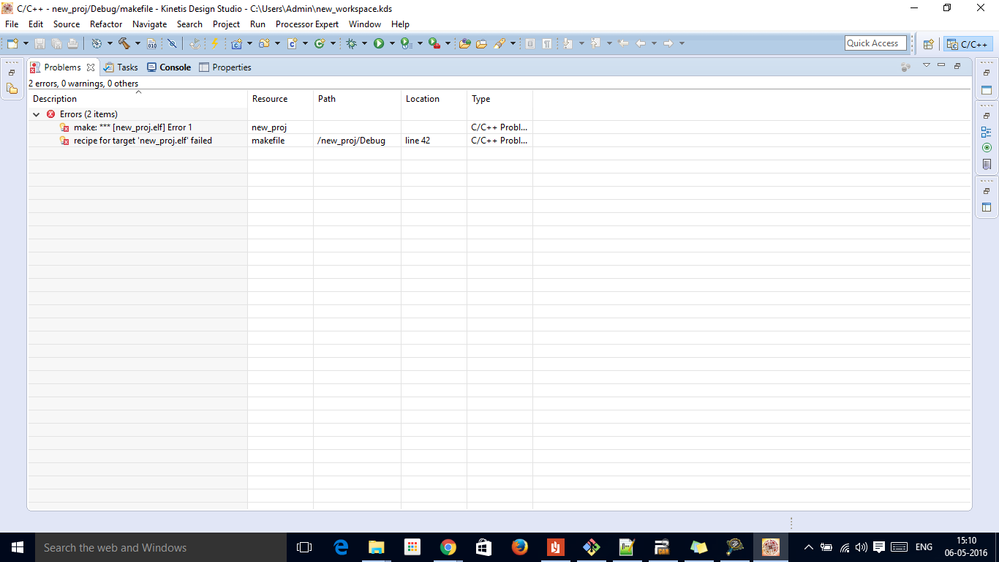

    I wanted to create a project in kds and run KEA-128 demo UART code given by NXP but it is showing me error in makefile.
     I have attached the project and the screen shot of the error also.
How to fix this?

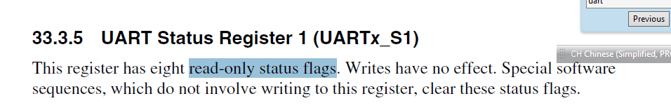

Hello ,
First ,your code have error  , the register of UART_S1 is a read-only status flags,
can not write :
while on your code :
Hope it helps
