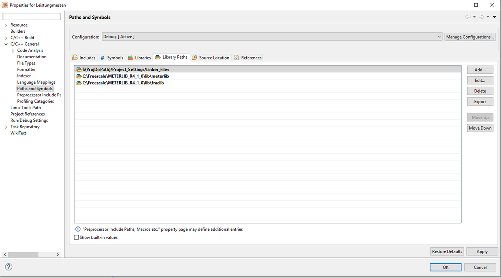

I bought the TWR-KM34Z75M development kit.
I would like to realize a 1 phase energy measurement with it.
However, it does not want to work. There are already problems building the project using the example program.
I have read the document "Filter-Based Algorithm for Metering Applications" and have tried to program using the example program on page 79 and 80.
My IDE is the Kinetis Design Studio, Version: 3.2.0

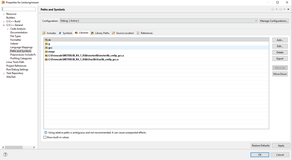

I followed the instructions in the document in chapter 4.1.1 on page 25 and added the required libraries and includs.
The required configuration file was created and icluded.
When building the project I get the following error message:
Can anyone give me a hint how to solve the problem ?

Hi Hurek,
The problem here is that you are not using the appropriate IDE for this project. This reference design was made for IAR IDE. That is the reason why it does not compile on your side.
I hope it helps!
Felipe

dariusz_hurek
But why is it stated in the document that it can also be done with the GCC compiler? Libraries and required includes are given. The Kinetis Design Studio uses the GCC compiler.

Hi Hurek,
I see what you mean. In table 7 of the Filter Based Algorithm Metering Applications document it is stated how to integrate the library into your application to work with different compilers. However, we do not have any example already developed using KDS. We only have projects for IAR IDE.
Sorry for the inconvenience this may cause you.
