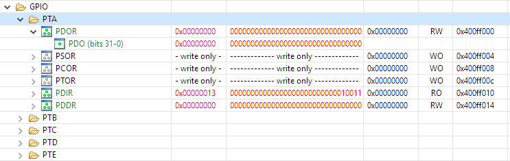

You have to double-click on the entry, see "using the plugin" in How to Add Register Details View in Eclipse | MCU on Eclipse

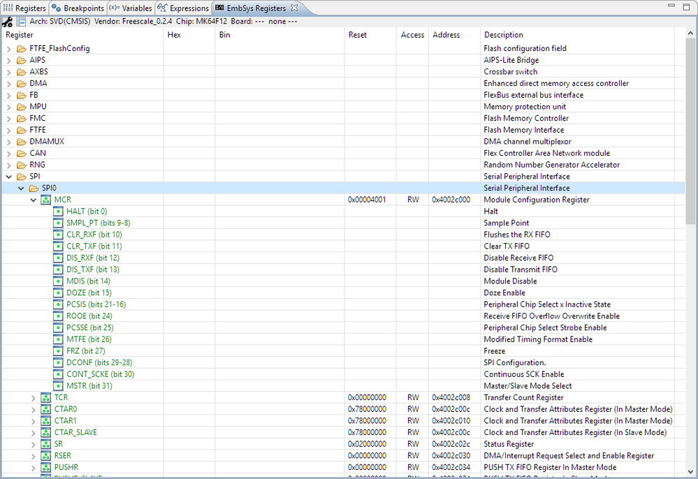

720adams
Erich:
I am running some code that is blinking my Red LED on the FRDM-K64F
board.  As you can see from the "portMem.png" image attached while the
code is running and blinking the LED I try to read memory.  All I get
are ?????.  The other two images attached are of the same region
attempting to be read through the Emb Sys Registers window, and of the
Emb Sys Registers window trying to read the port configuration memory area.
I am still thinking there is a setting in my code that may be the
culprit so I will try running your example next to see if I get the same
results.
Mike

720adams
I'm sorry but I must be missing something fundamental.  Those values
shown in your .png file show up green just like mine do, but there are
no register values in the BIN and HEX columns.  Shouldn't this be where
the values of these registers are filled in indicating the data that is
in theses registers and the bits thereof?
I must not be understanding something.  I'm sorry for being dense if it
is simple and I'm just not seeing it.
Mike
19,609 Views
BlackNight
Hi Mike,
ah, now I'm getting your point. I thought your point was that you are not able to see the register value at all.
Yes, it would be good if that plugin would show the bit details. It does it for other peripherals as for the GPIO:
I have not checked the implementation fot hat plugin which is maintained by the community (SourceForge https://sourceforge.net/projects/embsysregview/files/embsysregview/0.2.6/  is down for maintenance right now, but there is Eclipse Embedded Systems Register View / Code / [r195] /trunk ).
I had contributed in the past a few fixes because that plugin did not correctly parse the ARM SVD files, so I think this is the case here as well. What I have been using so far is the 32bit hex values for my debugging. I agree that this is not ideal, but has worked for me. The other consideration would be to use the MCUXpresso IDE as it has replaced KDS, and the MCUXpresso comes with a NXP maintained peripheral registers view (The Peripherals+ view, see Overview of MCUXpresso IDE v10.2.0 | MCU on Eclipse  and Peripherals Viewer | MCU on Eclipse ).

I tried the PTA registers in my FRDM-K64F through the OpenSDA USB port.
Unfortunately, I do not get the same result as you.  I still see the
name turn green in the KDS tool, but nothing is filled in for the hex or
binary columns regarding the register's data.  Additionally the data
that appears to be going to the OpenSDA port--(when viewing the
transactions in the Console window) appear to be returning a negative
1.  I'm assuming the reset column is what the register will be set to
out of reset and not the current value, right?
I have tried upgrading the KDS embsysregview tool from the eclipse
marketplace and the sourceforge trees.  Unfortunately, KDS would not
update even when trying to do this as the root user.  I'd be happy to
try other locations if it will fix this issue.

BlackNight
Hi Mike,
the first column is the actual value, followed by the same value in binary, followed by the reset value.
I suggest that you load an example project which say blinks an LED, then inspect the registers for that LED.
If the LED blinks, the port is clocked and you should be able to read and see it.
Otherwise, can you post a screenshot of what you see?
Erich
