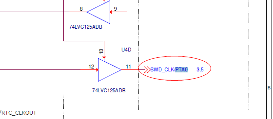

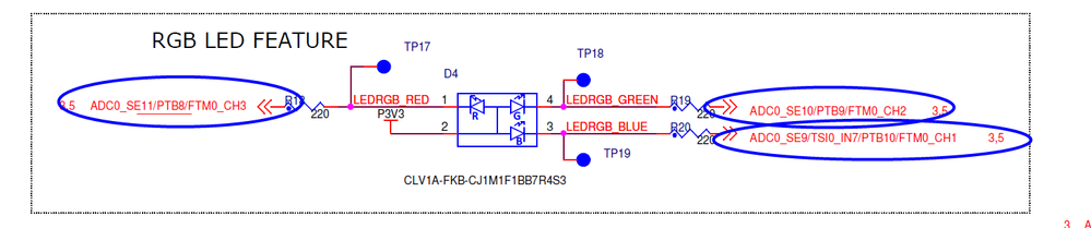

Hello Juan,
I have checked your code.  Please have a look at the SCH for FRDM-KL05 board,
the PTA0 connect to SWD_CLK pin , it also means, we used it  when debugging .
Please change another gpio that haven't used, for example , you can test the LDEs :
Hope it helps
TIC

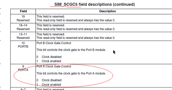

Hello Juan Diego Scarini ,
Have you enable the PORTA clock ?
And why you use the initialize  funciont GPIO_DIR0_Init() , not the Bit1_Init() when
you use the component of BitIO_LDD .
If still can't work , please send  your whole project to me, I will help you check it on my side .
Hope it helps
TIC

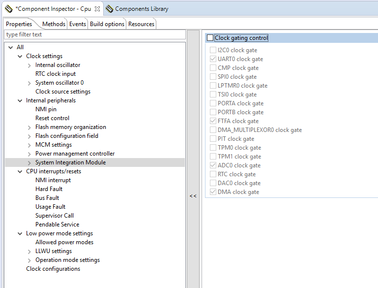

juansalvo94
Hi Alice! Thank you for your answer.
Looking at what you said, i've checked PE Processor Component, SIM Module.
There I found that there was no clock gating on PORTA and PORTB (Ports that I use)
So I've enabled the Clock Gating Control and when I enable it, the PORTA and PORTB options enable automatically.
Well, I've deceided to run the code in debugging mode, but when it comes to the initialization part, It freezes! The fail is in the exact same point.
The SIM_SCGC5 has the correct value 0x780, but it still freezes on the same part:
PORTA_PCR0 = (uint32_t)((PORTA_PCR0 & (uint32_t)~(uint32_t)(PORT_PCR_ISF_MASK |PORT_PCR_MUX(0x06))) | (uint32_t)(PORT_PCR_MUX(0x01)));
And i've got no ideas on what to do...
Thank you
Juan

Hello Juan,
Hope it helps
TIC
