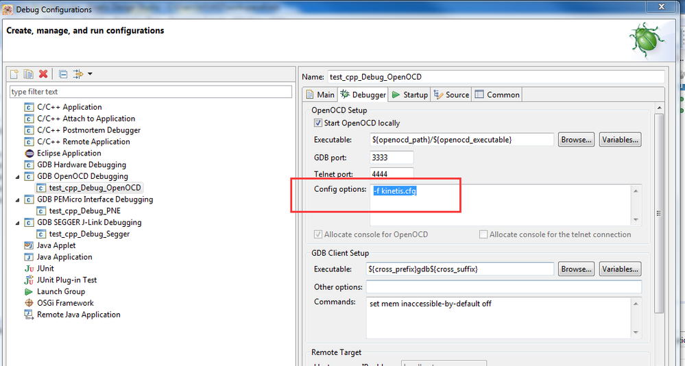

I have a  twrke18f board, and I just starting out using KDS 3.2 and
trying a simple hello world project from SDK_2.0_TWR-KE18F.
what sub-directory is needed for  kinetis.cfg for whatever Debugger Config options file.
Where is there a description of the options possible for the .cfg file?

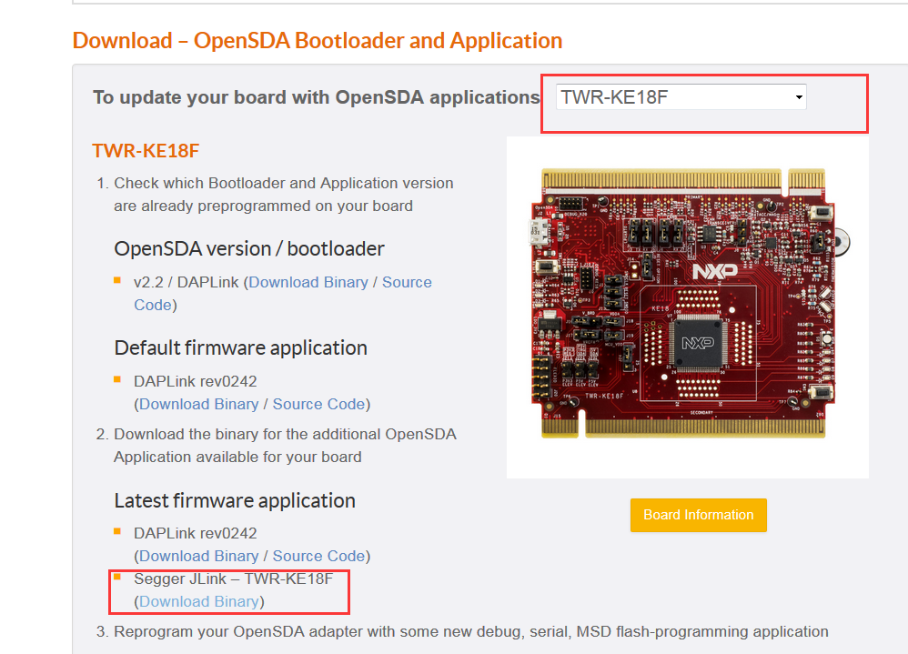

Hello David,
Yes,  i think the DAPlink not support this board now , so please use the Jlink .

Hello David,
Could you please take a screenshot about your problem.
For example where shows "what sub-directory is needed for  kinetis.cfg for whatever Debugger Config options file."
also show the error massage.
In the GDB OpenOCD debug mode :
Alice

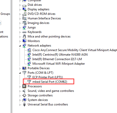

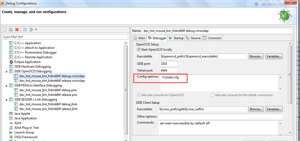

Hello David,
1. Please change   -f 'kinetis.cfg' to   -f kinetis.cfg  , have a try.
2. After connect your board ,Please share the "Device Manager" of your PC, about the Ports :

davidpotter
Hi Alice,
I removed the quote and the attachment shows the error.
the device DAPLink CMSIS-DAP device shows up in the Devices and Printers and the properties claim the device is working properly
Under the device manager, I see under
portable device, DAPLINKBOOT
Line 3 of kinetis.cfg is
interface cmsis-dap

Hello David,
- I h ave not this board, while when i set the other kinetis board to CDSIS-DAP bootloader mode,
it should shows:
- If still can not work , you can also test the Jlink bootloader to have a try .
You can find the firmware at here:
OpenSDA Serial and Debug Adapter|NXP
SEGGER - The Embedded Experts - Downloads - J-Link / J-Trace
Hope it helps
