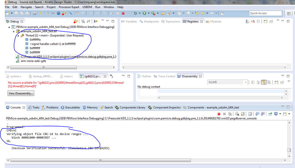

I have been using kinetis design tool to debug my code on microcontroller KL04z. Is there a way to run image with starting address at 0x1000 instead of 0x0 in KL04z on PEMicro debugger on KDS.
I have done the followings but in vain:
1. Change the following in MemoryMap-mkl04z32m4.ld to
  rom        (rx)  : ORIGIN = 0x1000, LENGTH = 0x7000
2. build the image
3a. On KDS, run PEMicro debugger => Not work. Stuck at 0xfffffffe
3b. On KDS, run PEMicro debugger, on runtime options setting PC to 0x1000 => not work. Stuck at 0xfffffffe.
Please see attached result.
Thanks a lot.

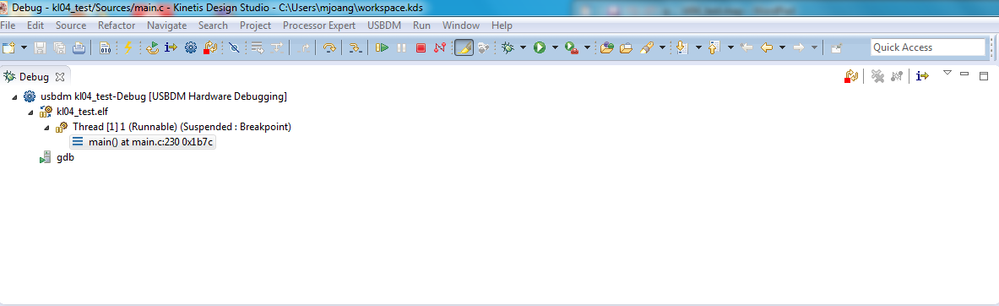

Thanks for your reply.  I did not have a bootloader to run at address 0x0. I thought that PEMicro Multilink FX debugger could force KL04 to start from 0x1000 by setting start PC at 0x1000.
Previously, when using FRDM-KL05z as usbdm debugger, the image could run properly from 0x1000 even without bootloader at 0x0:Capture_usbdm.PNG.png
So, I thought I could do the same on PEMicro  Multilink FX  debugger.  Probably, I am wrong.

mjoa
Hi Jorge,
Sorry for delay. I have been pulled off to work on something else.
I have just tested your project. It works.
My project was created using USBDM tab on KDS. The structure as well as startup code in my usbdm-created project is quite different from yours.
Finally, the memory map is defined in ..\Project_Settings\Linker_Files\MemoryMap-mkl05z32m4.ld
The original setting is
MKL05Z32M4
MEMORY
  ram        (rwx) : ORIGIN = 0x1FFFFC00, LENGTH = 0x00001000
  rom        (rx)  : ORIGIN = 0x00000000, LENGTH = 0x00008000
  io         (rwx) : ORIGIN = 0x40000000, LENGTH = 0x00080000
  io_1       (rwx) : ORIGIN = 0x400FF000, LENGTH = 0x00001000
  io_2       (rwx) : ORIGIN = 0x44000000, LENGTH = 0x1C000000
  io_3       (rwx) : ORIGIN = 0xE0000000, LENGTH = 0x00100000
  io_4       (rwx) : ORIGIN = 0xF0000000, LENGTH = 0x00001000
  io_5       (rwx) : ORIGIN = 0xF0001000, LENGTH = 0x00001000
  io_6       (rwx) : ORIGIN = 0xF0002000, LENGTH = 0x00001000
  io_7       (rwx) : ORIGIN = 0xF0003000, LENGTH = 0x00001000
  io_8       (rwx) : ORIGIN = 0xF8000000, LENGTH = 0x08000000
I have modified it into
MKL05Z32M4
MEMORY
  rom        (rx)  : ORIGIN = 0x00001000, LENGTH = 0x00007000 <= change
