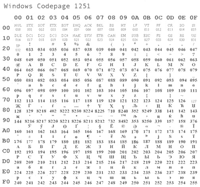

I have problem with cyryllic chars in KDS.
I use Kinetis KL46 (ARM Cortex M0+) and defalult GNU C Compiler.
I declare chars like below. There is problem only with cyryllic chars.......
My declaration and initiations:
static const char RUFont1[]= "1234567890-=";
static const char RUFont2[]= "йцукенгшщзхъ";
static const char RUFont3[]= "фывапролджэ";
static const char RUFont4[]= "ячсмитьбю";
static const char RUFont5[]= "ЙЦУКЕНГШЩЗХЪ";
static const char RUFont6[]= "ФЫВАПРОЛДЖЭ";
static const char RUFont7[]= "ЯЧСМИТЬБЮ";
What I have to do in KDS to have a values in arrays of chars like in the ASCII table below?
For example I want to have:
Б = 193
Щ = 217
Ф = 212 etc....
while I have from compilator different values, for examples:
Б = 208 etc.
I tried to change codeparge in KDS like
Window > Preferences > General > Workspace, set "Text file encoding" to "Other : UTF-8
but withaut good effect...
Could anyone know what I have to change, set..?
I will be very grateful for help

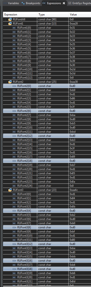

piotrdzierzak
I show the arrays from debuger:
The most frequently code chars is 0xDO(h)...
Like you see the number 12345.. are ok while the cyrillic chars not...
