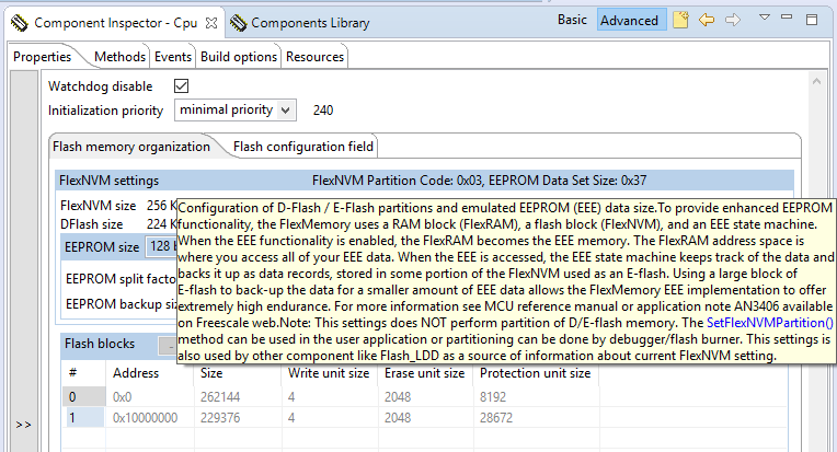

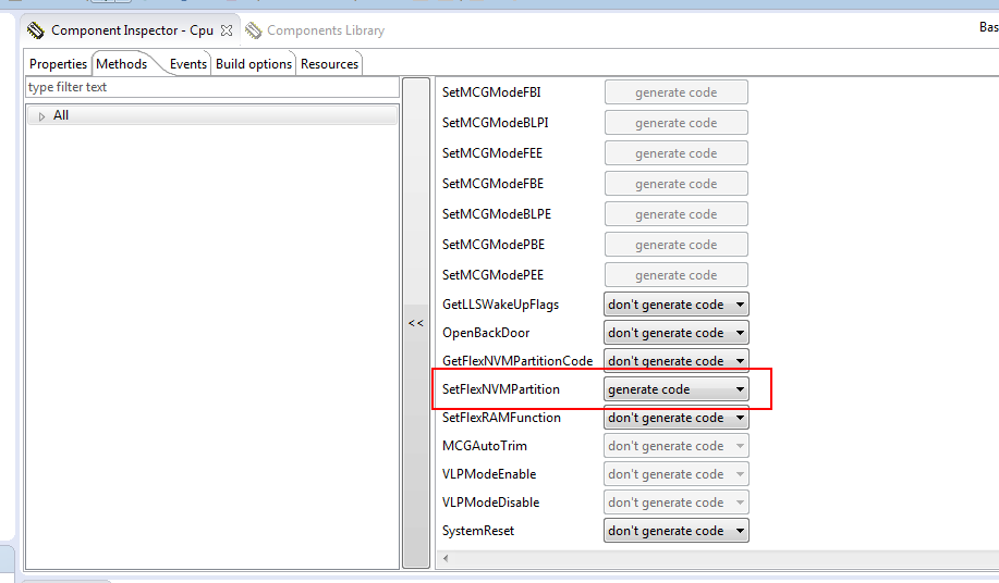

I have looked up similar examples in the NXP site such as 607244  In this example the Methods list for the cpu component includes the option to generate the above methods.  On my KDS/PE I don't get this option.  See screenshots below.

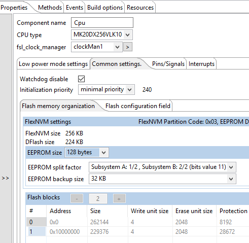

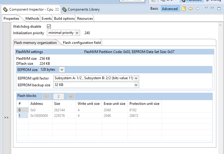

Below is my EEPROM configuration.
Below when hovering over the FlexNVM option it indicates to call SetFlexNVMPartition() to configure the EEPROM but this function is not generated for my build.

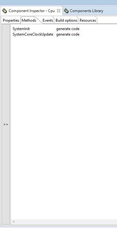

And I don't get a SetFlexNVMPartition() method in the CPU list of methods.

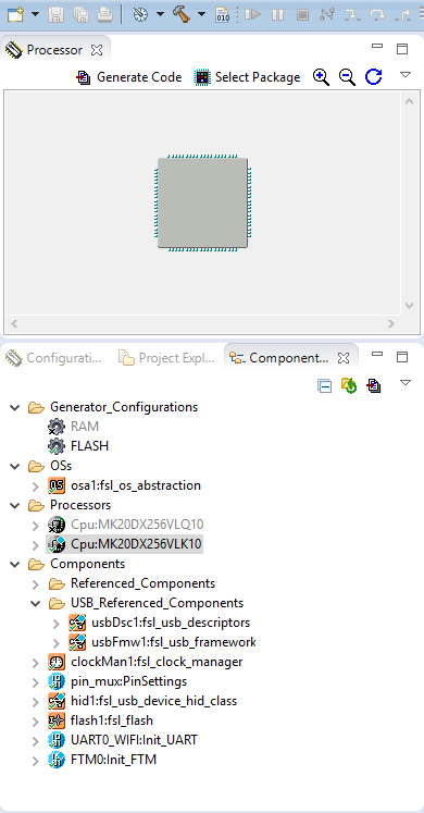

Below, just to confirm CPU type.
Also attached is a demo K20 project where I try to configure the EEPROM in the CPU component settings.

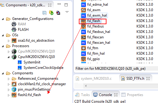

Does this function can meet your requirement ?
I yes , please add the component of "fsl_flash" on your project , it include most of the operate of flash.

The SetFlexNVMPartition() method is when we create one Processor Expert project (without KSDK) on
kds,  your project is KSDK+PE, pay attention that the two are different。
About create the PE project , when you create project , please select the None in the kinetis SDK:

Hello Sean,
Hope it helps

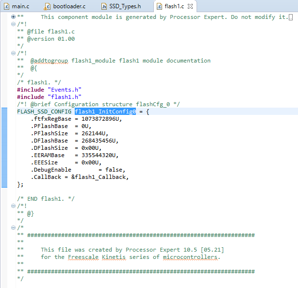

The fsl_flash component generates the structure for the FLASH_SSD_CONFIG  when I 'Generate Code' in PE.
But the DFLashSize and EEESize fields are shown as zero.  From my FlexNVM configuration in the cpu component I would expect my DFlashSize to be 224Kbyte and 32Kbyte respectively.
Are the values in flash1_InitConfig0 correct for my configuration or do I have to overwrite them before calling the DEFlashPartition() function?  Or does it not matter?
My FlexNVM settings are ;

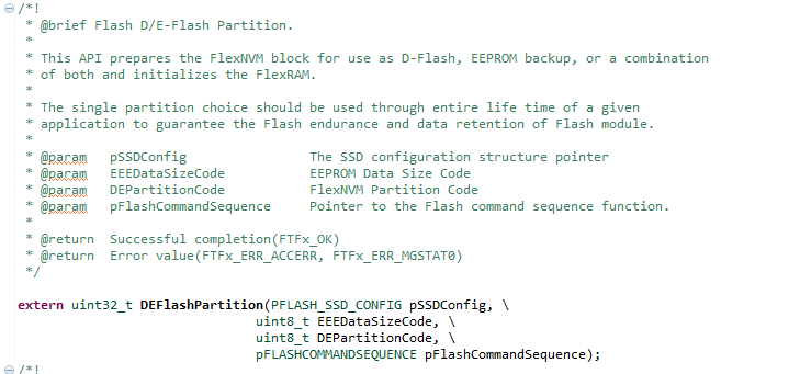

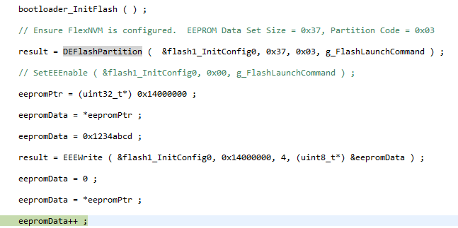

I have tried the DEFlashPartition() method but I still have problems trying to write to EEPROM.
The DEFlashPartition()  now returns the code 0x20 and the flashConfig structure looks like the FlexNVM has been configured as I expect with 128 bytes EEPROM space in 32 Kbytes of FlexNVM.
When I read the EEPROM space directly at 0x14000000 I read FFs,  which seems OK as it is blank.
I then try to write to the EEPROM via the EEEWrite() method.
This returns a code of zero (OK?) but the EEPROM data at 0x14000000 remains at FF  (I try to write 0x1234abcd)
Can you advise me if I am doing anything incorrectly here, or maybe missing a step.
Below is my code, the bootloader_InitFlash()  puts the Flash function into ram and I then try to read/write to EEPROM.  Read is OK, reads 0xFFFFFFFF, but also reads 0xFFFFFFFF after the EEWrite()

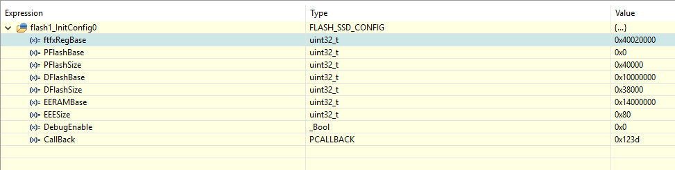

And below is the contents of the FlashConfig structure, which looks OK, 128 bytes of EEPROM and 0x38000 bytes of DFlash.

seanbolton
I think I have resolved this problem.  I should only call DEFlashPartition()  once when not configured.  If I do this then I can write to the EEPROM area OK.
I check if the FlexNVM is already partitioned by looking at the EESize in the flashpartition structure.
if ( flash1_InitConfig0.EEESize != 0x80 )
    // DEFlashPartition should only be called once when FlexNVM is not setup.
    // So after first factory boot up this function should never be called again.
    result = DEFlashPartition (  &flash1_InitConfig0, 0x37, 0x03, g_FlashLaunchCommand ) ;
// Test write and read to EEPROM
eepromData = 0x12345678 ;
result = EEEWrite ( &flash1_InitConfig0, 0x14000000, 4, (uint8_t*) &eepromData ) ;
eepromData = * ((unsigned int*) 0x14000000) ;
So I think my FlexNVM is working OK.  I can also write to the DFlash Space which is not allocated to EEPROM emulation.
