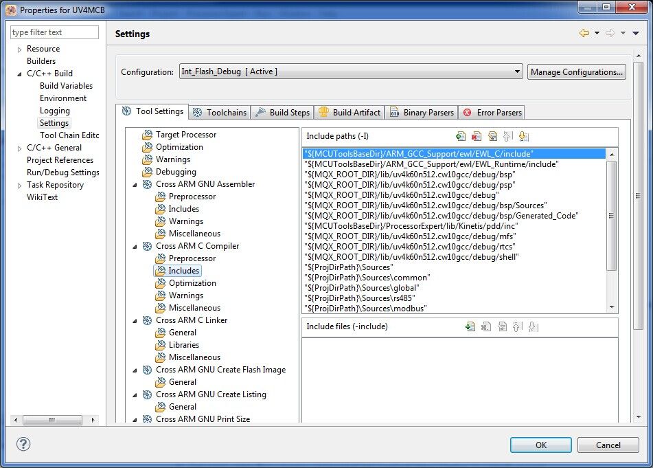

Since that there isn't MQX project wizard in KDS even all MQX plug-ins are installed in KDS, I created a MQX 4.0 project in CodeWarrior 10.6 with GCC selectd. Several MQX stack libs like mfs, rtcs, shell are used in this project. The project was built correctly in CodeWarrior. But afterI I imported(no matter copy the whole project or not) it into KDS and converted it to a KDS project, the new project can't pass the building with following errors.

arm-none-eabi-gcc -mcpu=cortex-m0plus -mthumb -O0 -fmessage-length=0 -fsigned-char -ffunction-sections -fdata-sections -Wall  -g3 -gstrict-dwarf -T E:\UV4\fw\MQX_4_0_UV4K60N512\lib\uv4k60n512.cw10gcc\debug\bsp\intflash.ld -Xlinker --gc-sections -L"C:\Freescale\CW_MCU_v10.6\eclipse\../MCU/ARM_GCC_Support/ewl/lib/armv7e-m" -Wl,-Map,"UV4MCB.map" -n -z muldefs --start-group "E:\UV4\fw\MQX_4_0_UV4K60N512/lib/uv4k60n512.cw10gcc/debug/psp/psp.a" -Xlinker --end-group --start-group "E:\UV4\fw\MQX_4_0_UV4K60N512/lib/uv4k60n512.cw10gcc/debug/bsp/bsp.a" -Xlinker --end-group --start-group "E:\UV4\fw\MQX_4_0_UV4K60N512/lib/uv4k60n512.cw10gcc/debug/mfs/mfs.a" -Xlinker --end-group --start-group "E:\UV4\fw\MQX_4_0_UV4K60N512/lib/uv4k60n512.cw10gcc/debug/rtcs/rtcs.a" "E:\UV4\fw\MQX_4_0_UV4K60N512/lib/uv4k60n512.cw10gcc/debug/bsp/bsp.a" "E:\UV4\fw\MQX_4_0_UV4K60N512/lib/uv4k60n512.cw10gcc/debug/psp/psp.a" -Xlinker --end-group --start-group "E:\UV4\fw\MQX_4_0_UV4K60N512/lib/uv4k60n512.cw10gcc/debug/rtcs/rtcs.a" "E:\UV4\fw\MQX_4_0_UV4K60N512/lib/uv4k60n512.cw10gcc/debug/mfs/mfs.a" "E:\UV4\fw\MQX_4_0_UV4K60N512/lib/uv4k60n512.cw10gcc/debug/bsp/bsp.a" "E:\UV4\fw\MQX_4_0_UV4K60N512/lib/uv4k60n512.cw10gcc/debug/psp/psp.a" -Xlinker --end-group --start-group "E:\UV4\fw\MQX_4_0_UV4K60N512/lib/uv4k60n512.cw10gcc/debug/rtcs/rtcs.a" "E:\UV4\fw\MQX_4_0_UV4K60N512/lib/uv4k60n512.cw10gcc/debug/shell/shell.a" "E:\UV4\fw\MQX_4_0_UV4K60N512/lib/uv4k60n512.cw10gcc/debug/bsp/bsp.a" "E:\UV4\fw\MQX_4_0_UV4K60N512/lib/uv4k60n512.cw10gcc/debug/psp/psp.a" -Xlinker --end-group --start-group "E:\UV4\fw\MQX_4_0_UV4K60N512/lib/uv4k60n512.cw10gcc/debug/rtcs/rtcs.a" "E:\UV4\fw\MQX_4_0_UV4K60N512/lib/uv4k60n512.cw10gcc/debug/mfs/mfs.a" "E:\UV4\fw\MQX_4_0_UV4K60N512/lib/uv4k60n512.cw10gcc/debug/shell/shell.a" "E:\UV4\fw\MQX_4_0_UV4K60N512/lib/uv4k60n512.cw10gcc/debug/bsp/bsp.a" "E:\UV4\fw\MQX_4_0_UV4K60N512/lib/uv4k60n512.cw10gcc/debug/psp/psp.a" -Xlinker --end-group --start-group "E:\UV4\fw\MQX_4_0_UV4K60N512/lib/uv4k60n512.cw10gcc/debug/shell/shell.a" -Xlinker --end-group --start-group -lgcc -lstdc++ -lm -lrt -lc++ -lsupc++ -lc -Xlinker --end-group "C:\Freescale\CW_MCU_v10.6\eclipse\../MCU/../MCU/ARM_GCC_Support/ewl/lib/armv7e-m/__arm_start.o" "C:\Freescale\CW_MCU_v10.6\eclipse\../MCU/../MCU/ARM_GCC_Support/ewl/lib/armv7e-m/__arm_end.o" "E:\UV4\fw\MQX_4_0_UV4K60N512/lib/uv4k60n512.cw10gcc/debug/psp/psp.a" "E:\UV4\fw\MQX_4_0_UV4K60N512/lib/uv4k60n512.cw10gcc/debug/bsp/bsp.a" "E:\UV4\fw\MQX_4_0_UV4K60N512/lib/uv4k60n512.cw10gcc/debug/mfs/mfs.a" "E:\UV4\fw\MQX_4_0_UV4K60N512/lib/uv4k60n512.cw10gcc/debug/rtcs/rtcs.a" "E:\UV4\fw\MQX_4_0_UV4K60N512/lib/uv4k60n512.cw10gcc/debug/shell/shell.a" Sources/common/common.c Sources/common/circlebuf.c Sources/common/myassert.c Sources/global/global.c Sources/io/gpio.c Sources/rs485/rs485.c Sources/rs485/rs485_bb.c Sources/modbus/mbs.c Sources/modbus/mbs1.c Sources/modbus/mbs2.c Sources/modbus/mbs_bb.c Sources/accelerometer/accel.c Sources/web/tfs_data.c Sources/web/websvr.c Sources/main.c -o "UV4MCB.elf"  ./Sources/web/tfs_data.o ./Sources/web/websvr.o  ./Sources/rs485/rs485.o ./Sources/rs485/rs485_bb.o  ./Sources/modbus/mbs.o ./Sources/modbus/mbs1.o ./Sources/modbus/mbs2.o ./Sources/modbus/mbs_bb.o  ./Sources/io/gpio.o  ./Sources/global/global.o  ./Sources/common/circlebuf.o ./Sources/common/common.o ./Sources/common/myassert.o  ./Sources/accelerometer/accel.o  ./Sources/main.o  C:/Freescale/CW_MCU_v10.6/eclipse/../MCU/../MCU/ARM_GCC_Support/ewl/lib/armv7e-m/__arm_start.o C:/Freescale/CW_MCU_v10.6/eclipse/../MCU/../MCU/ARM_GCC_Support/ewl/lib/armv7e-m/__arm_end.o E:/UV4/fw/MQX_4_0_UV4K60N512/lib/uv4k60n512.cw10gcc/debug/psp/psp.a E:/UV4/fw/MQX_4_0_UV4K60N512/lib/uv4k60n512.cw10gcc/debug/bsp/bsp.a E:/UV4/fw/MQX_4_0_UV4K60N512/lib/uv4k60n512.cw10gcc/debug/mfs/mfs.a E:/UV4/fw/MQX_4_0_UV4K60N512/lib/uv4k60n512.cw10gcc/debug/rtcs/rtcs.a E:/UV4/fw/MQX_4_0_UV4K60N512/lib/uv4k60n512.cw10gcc/debug/rtcs/rtcs.a E:/UV4/fw/MQX_4_0_UV4K60N512/lib/uv4k60n512.cw10gcc/debug/rtcs/rtcs.a E:/UV4/fw/MQX_4_0_UV4K60N512/lib/uv4k60n512.cw10gcc/debug/rtcs/rtcs.a E:/UV4/fw/MQX_4_0_UV4K60N512/lib/uv4k60n512.cw10gcc/debug/shell/shell.a -l"gcc" -l"stdc++" -l"m" -l"rt" -l"c++" -l"supc++" -l"c"
arm-none-eabi-gcc: error: Sources/common/common.c: No such file or directory
arm-none-eabi-gcc: error: Sources/common/circlebuf.c: No such file or directory
arm-none-eabi-gcc: error: Sources/common/myassert.c: No such file or directory
arm-none-eabi-gcc: error: Sources/global/global.c: No such file or directory
arm-none-eabi-gcc: error: Sources/io/gpio.c: No such file or directory
arm-none-eabi-gcc: error: Sources/rs485/rs485.c: No such file or directory
arm-none-eabi-gcc: error: Sources/rs485/rs485_bb.c: No such file or directory
arm-none-eabi-gcc: error: Sources/modbus/mbs.c: No such file or directory
arm-none-eabi-gcc: error: Sources/modbus/mbs1.c: No such file or directory
arm-none-eabi-gcc: error: Sources/modbus/mbs2.c: No such file or directory
arm-none-eabi-gcc: error: Sources/modbus/mbs_bb.c: No such file or directory
arm-none-eabi-gcc: error: Sources/accelerometer/accel.c: No such file or directory
arm-none-eabi-gcc: error: Sources/web/tfs_data.c: No such file or directory
arm-none-eabi-gcc: error: Sources/web/websvr.c: No such file or directory
arm-none-eabi-gcc: error: Sources/main.c: No such file or directory
arm-none-eabi-gcc: error: unrecognized command line option '--start-group'
make: *** [UV4MCB.elf] Error 1

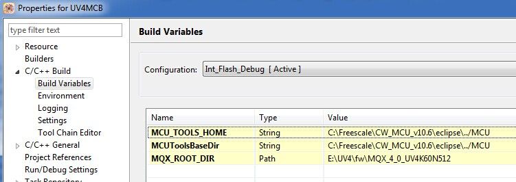

The needed build variables are correcly added as below.
And all the source path are included as below. I confirmed the ProjDirPath is right.

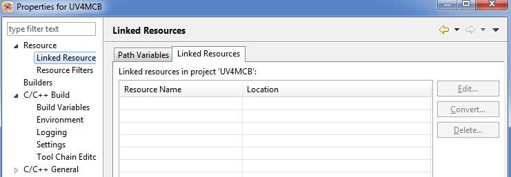

I searched on line and noticed someone mentioned the "Linked Resources" option. But in my project, this option is empty and can't be edited. It's the same in CodeWarrior IDE. It seems this option doesn't make sense.
So, what's the wrong indeed?

Hi Hengguang Yang,
KDS does not support classic MQX, MQX for KSDK is te MQX core with KSDK (Kinetis Software Development Kit) drivers, it is in beta phase and this version is supported in KDS. We are still working on documentation about how to migrate from classic MQX to MQX for KSDK. You can downlaod beta version form next link:
Freescale MQX™ RTOS for Kinetis SDK (BE|Freescale
In Beta version there is not an option in KDS wizard to create MQX for KSDK project, I recommend to make a copy of an existing demo or example and edit this project. You can find them in the following paths.
C:\Freescale\MQX_KSDK_1.0.0\demos
C:\Freescale\MQX_KSDK_1.0.0\rtos\mqx\mqx\examples
Hope this helps.
