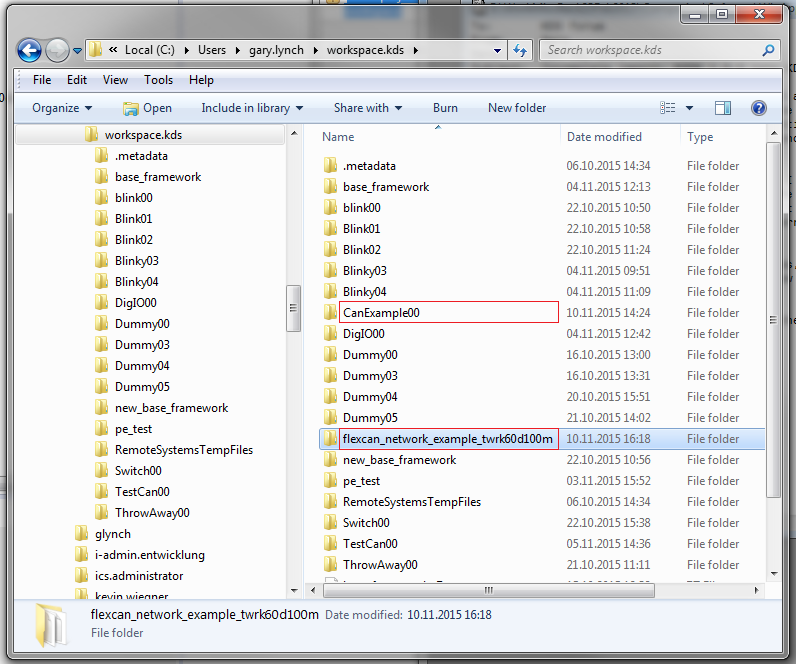

I took a look at the workspace with Windows Explorer. Oddly
enough, the project I tried to delete (plus one other) shows
up in the file pane, but not in the folder pane! I can click
down into it and see that it has no "Sources" sub-folder, in
which my other projects keep their main.c.

- Using Windows Explorer in my
  • C:\Users\gary.lynch\workspace.kds
  folder I can see the folder
  i2c_callback_slave_example_twrk60d100m, but under it I see
  only a .settings folder: no source or Includes folders, no
  source files, and no header files, although they all
  appear in my "Project Explorer " window.

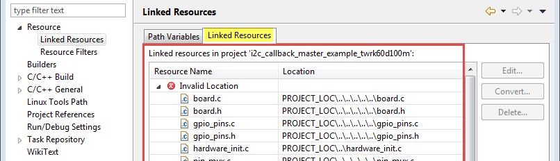

Hello Gary Lynch:
In short, the option "Copy projects into workspace" is not of any use with the example projects delivered with KSDK.
The reason is that all the files are linked using relative paths, referencing the original location of the project. There is a similar discussion in this thread: CW 10.6 Import/Copy to workspace Example Project(s) Issue .
In fact, after importing the project with the "Copy.." option checked, if you open the Project Properties -> Resource -> Linked Resources -> Linked Resources tab, you will see all of the links that are broken (invalid location):
Of course you can fix those links, but that is a tedious task.
