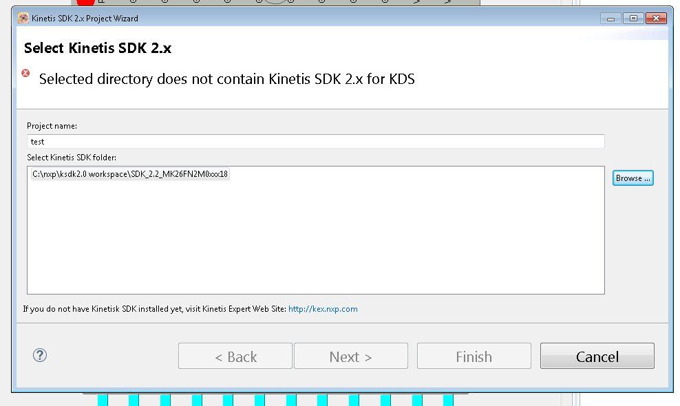

Hello.
I try to open a SDK v2.2 generated in config tools web site, and KDS do not allow, always show message " Selected directory does not contain Kinetis SDK 2.x for KDS ".
The SDK file was generated for KDS, and KDS has option to generate a Kinetis SDK 2.x project. After download the SDK I unzip in a folder, that I select in KDS project Wizard.
So, what is the problem ??.

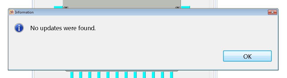

luishs
Senior Contributor I

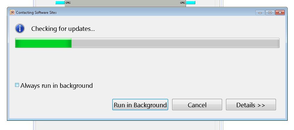

Thanks Marek.
I tried to update, but there are no updates, so can not update SDK 2.x Project Wizard.

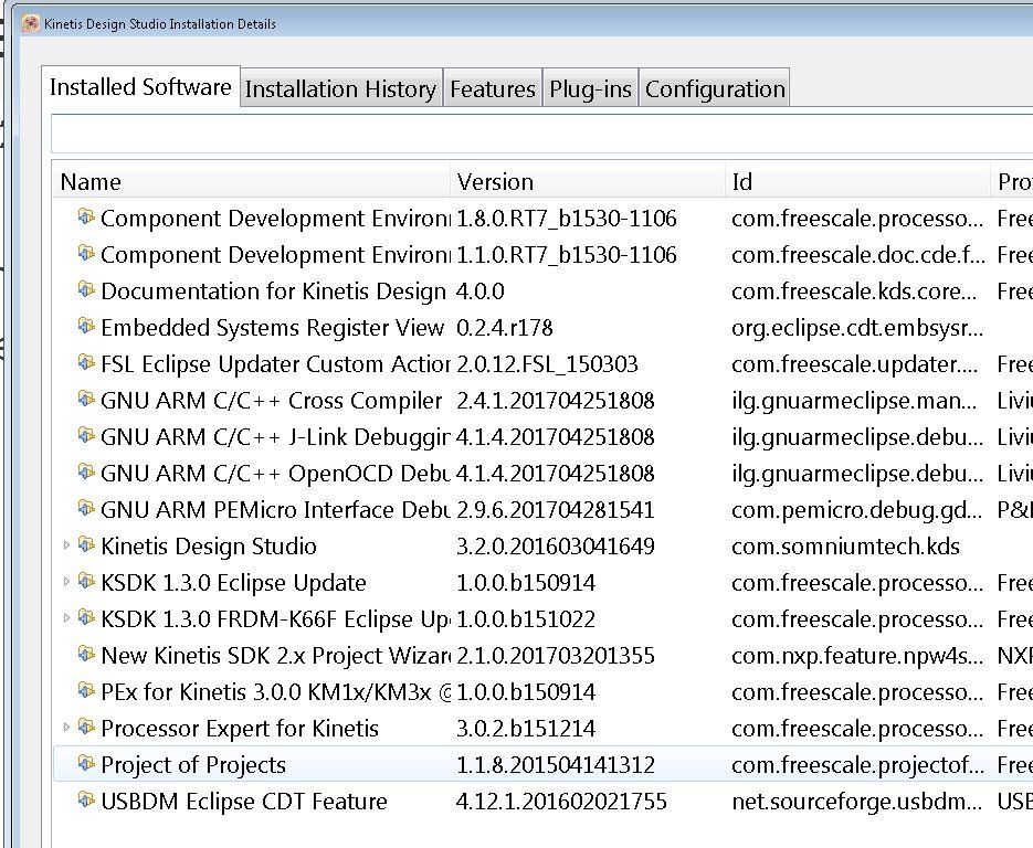

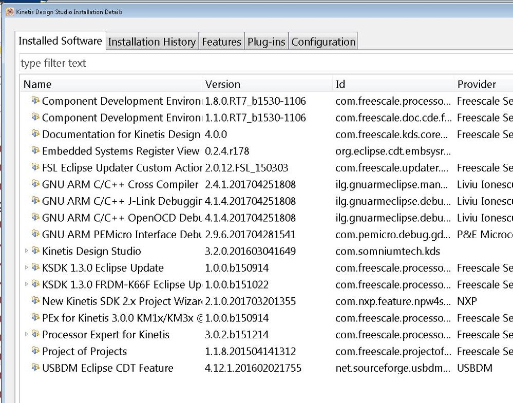

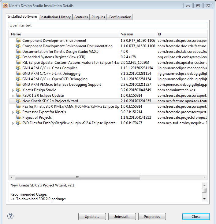

marek-trmac
Hi Luis HS,
check main menu - Help - About - Installation Details. New Project Wizard should be updated to version 2.1, see attached picture:
Marek
Marek
NOTE: If you find the answer useful, kindly click on [ACCEPT AS SOLUTION] button
2,278 Views
luishs
Yes, mine is with that version, but fail when try to create a project for SDK 2.x
2,278 Views
marek-trmac
Luis HS, can you let me know, what exactly SDK package are you using and what configuration?

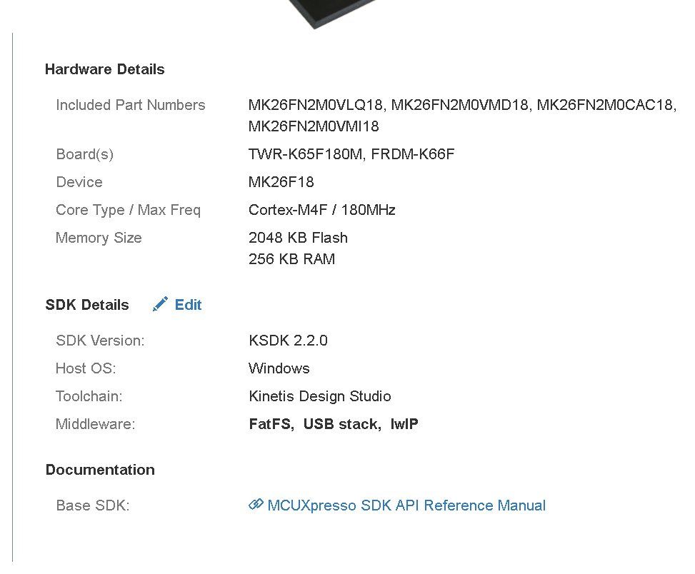

luishs
Hello Marek.
Attached the MK26FN2M0xxx18_manifest.xml file for MK26F microcontroller, in the SDK v2 that I made in config tools web site.
Kind Regards
2,278 Views
luishs
Yes, may see in picture I posted in my before reply, attached again. Its a MK26FN2M0VLQ18 microcontroller, file generated in NXP web site for KDS, SDK version KSDK 2.2.0. File dowloaded, and unzip in a folder, the folder I try to use to generate the SDK 2.x project, but fail.

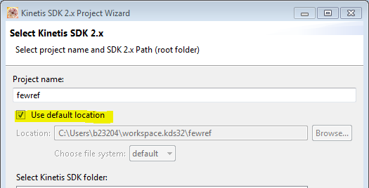

marek-trmac
Hi Luis,
I think New Project Wizard in your KDS is not updated properly. Here is how it looks on my computer:Capture.PNG
Can you try to remove it and install again:
  • Help - About - Installation Details -
  • Select New Kinetis SDK 2.x Project Wizard
  • Click on 'Uninstall' button
  • Help - Install New Software
  • Select 'KDS Update Site' from drop down
  • Select check box 'New Kinetis SDK 2.x Project Wizard'
  • Confirm to install
Hope this helps.
Marek
Marek
2,278 Views
luishs
Hello Marek.
Even with Unistall there were problems, all very strange, after Uninstall the SDK 2 Wizard, it was there yet and with no option to uninstall again. So, finally I have remove all, and install again KDS, and now work fine.
