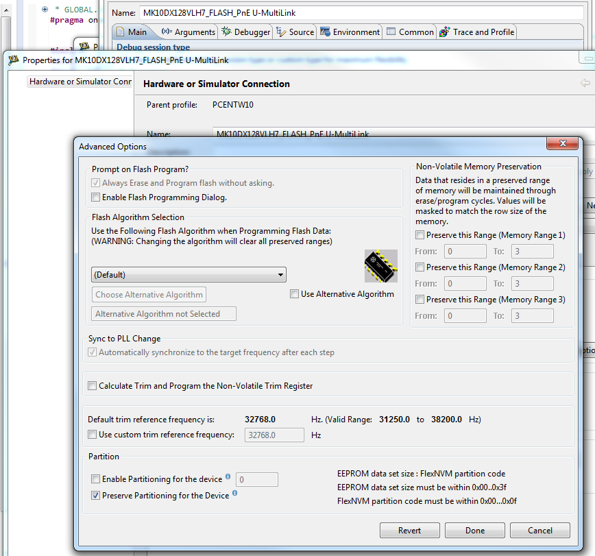

Okay thanks for your answer! Now I have read the Quick start guide, but I can't find my kinetic cpu MK10DX128VLH7 in the supported cpu list but I can create a project... So is this uC only not supported or are there any other problems while using it?
The next question is, where are the advanced programming settings? I search for this menu:
because I have to preserve the partitioning for the device and I have to preserve some memory ranges!
Pascal

that CPU is supported with Processor Expert projects. But it is not supported with Kinetis SDK projects (the SDK does not support that CPU).
The advanced programming dialog is a subject of Advanced debug configuration in KDS. To my knowledge this is not yet implemented in the P&E plugin.
You might consider using Segger J-Link for this (but I have not tried this function myself yet).
Erich

That are bad news for me... At the moment I haven't got any chance to debug my cpu (MK10DX128VLH7) completely, because the KDS does not support my cpu and the freescale support says that the bug in CW10.6 will not be fitted... (pls. see this topic: Strange behaviour of the Advanced Programming Options)
Do you have an idea what I can do now? Or will my cpu be supported in the near future in KDS?
Pascal

I quickly checked in KDS, and I can create a Processor Expert project for MK10DX128xxx7 and this supports the MK10DX128VLH7 package.
And if you do not want to use PEx, then simply do not use it in the project. Or remove the .pe file if you like to get it removed.
Or I'm missing something?
