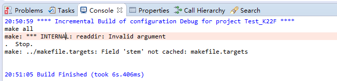

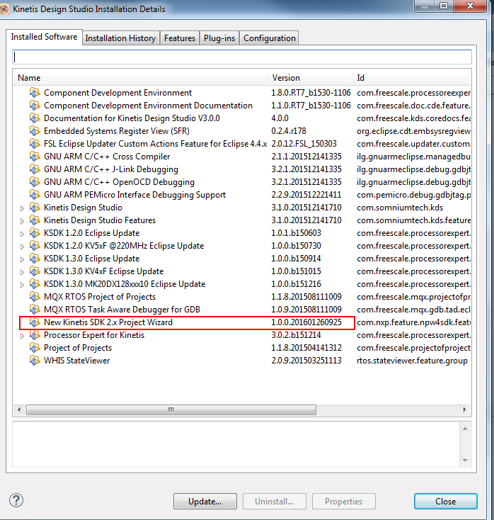

I was using KDS3.1 and KSDK 1.2 with PE without problem when making build for project Test_K22F. But couple of days ago I installed New Kinetis SDK 2.x Project Wizard and KSDK 2.0 package, then build error comes out when building the same project:
I'm not very familiar with gnu make tool, so just try to search the error in Internet search engine but still no help...
Does anybody get any advice?

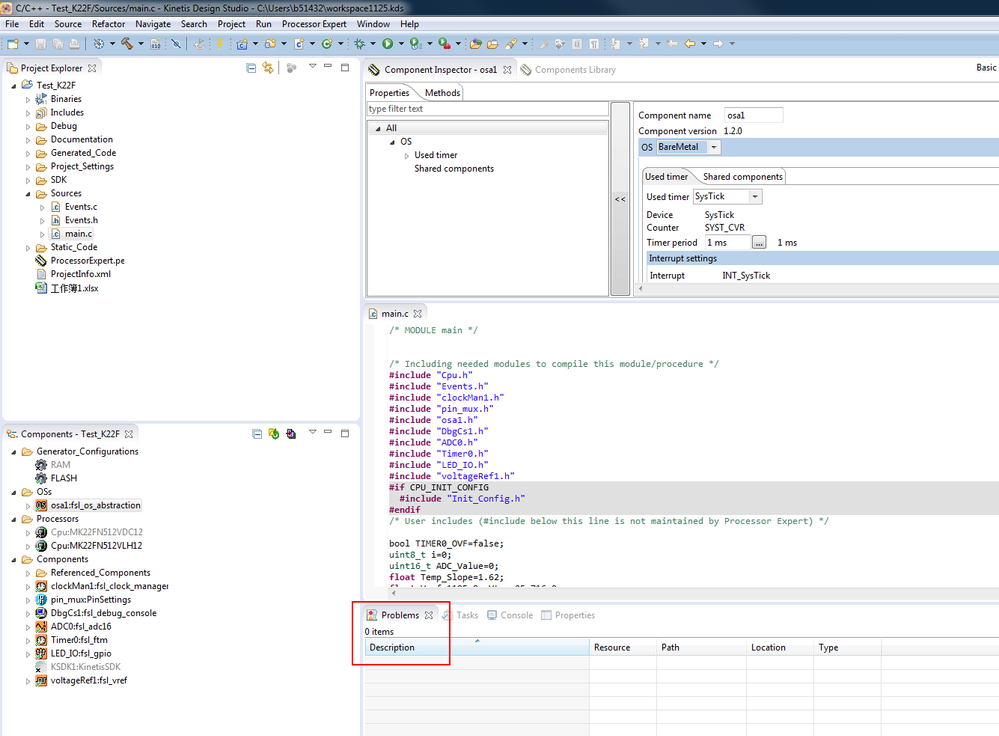

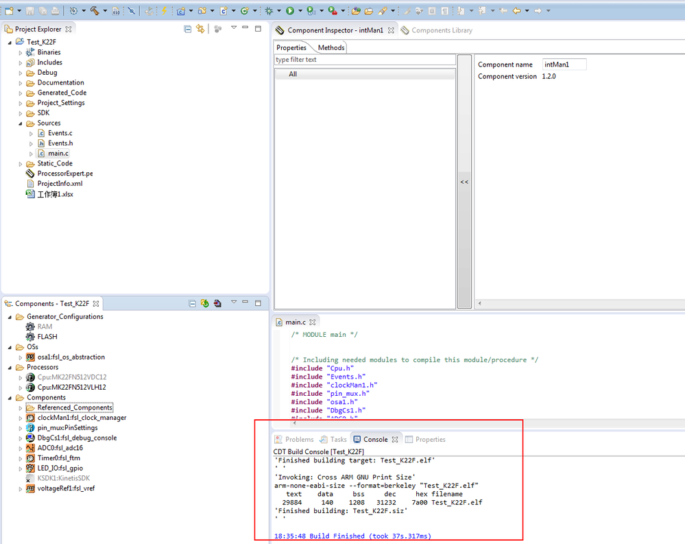

I knew finally the root cause, it looks very weird... Just FYI.
I pasted a .xlsx file in KDS project explorer so I can open it together with my codes in the same window, and this file may cause the issue. After I delete it, build is successful. I've repeated paste/delete actions for a few times and every times the same behavior.
I don't know why a .xlsx may cause this build issue and don't plan to deep dive into it. Just tell my finding.
