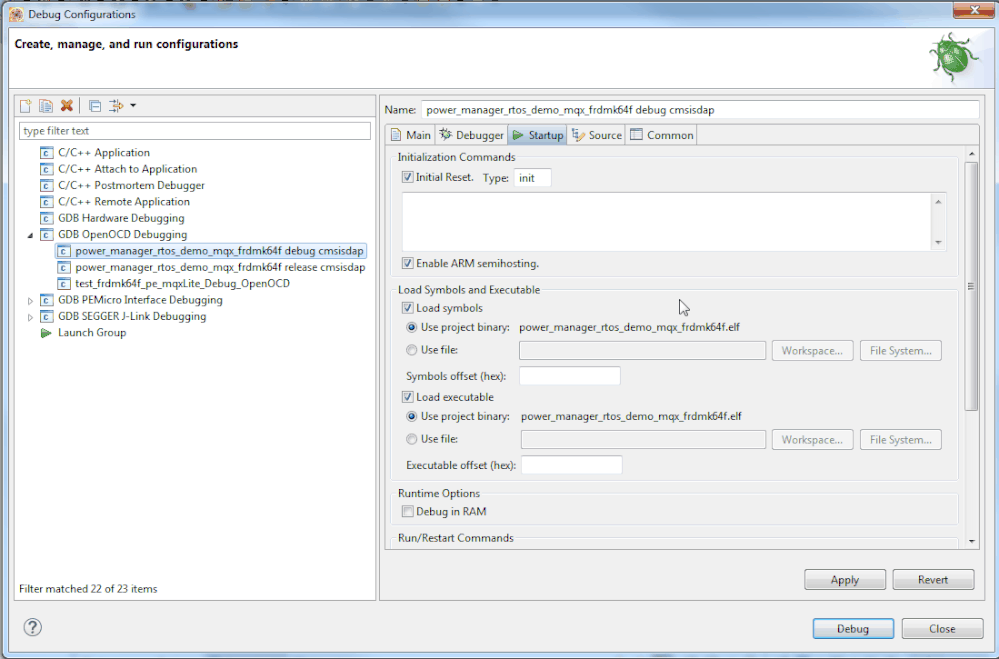

I am trying to debug on my Kinetis tower module without much success. My module currently shows up as an mbed Serial Port device so I am debugging with an OpenOCD configuration. Whenever I do, I receive the following error message:
Error in final launch sequence
Failed to execute MI command:
-target-select remote localhost:3333
Error message from debugger back end:
Remote communication error.  Target disconnected.: No error.
I've tried debugging with P&E/Segger and both time out.
How do I fix this problem?

DavidS
Hi Mitty,
I just tried this on my FRDM-K64F Freedom board that has MBED firmware so I would use the OpenOCD configuration as well.
The first time I downloaded I got the same error you had.
I then disconnected the debugger USB cable and then re-connected it.  Re-tried the download and it worked.
Here are my Debug Configuration settings:
David

mittymcdoogle
Thanks, David. I checked and I have all of the same settings, but I am still unable to debug.
Here is what my console is displaying every time I try to debug:
Open On-Chip Debugger 0.8.0-dev (2015-01-09-16:22)
Licensed under GNU GPL v2
For bug reports, read
  http://openocd.sourceforge.net/doc/doxygen/bugs.html
Info : only one transport option; autoselect 'cmsis-dap'
Info : CMSIS-DAP: SWD  Supported
Info : CMSIS-DAP: Interface Initialised (SWD)
Info : add flash_bank kinetis kinetis.flash
cortex_m reset_config sysresetreq
adapter speed: 1000 kHz
Started by GNU ARM Eclipse
Info : CMSIS-DAP: FW Version = 1.0
Info : SWCLK/TCK = 0 SWDIO/TMS = 1 TDI = 0 TDO = 0 nTRST = 0 nRESET = 1
Info : DAP_SWJ Sequence (reset: 50+ '1' followed by 0)
Info : CMSIS-DAP: Interface ready
Info : clock speed 1000 kHz
Info : IDCODE 0x2ba01477
Info : kinetis.cpu: hardware has 6 breakpoints, 4 watchpoints
Info : accepting 'gdb' connection from 3333
Error: Unsupported K-family FAMID
Error: auto_probe failed
Error: Connect failed. Consider setting up a gdb-attach event for the target to prepare target for GDB connect, or use 'gdb_memory_map disable'.
Error: attempted 'gdb' connection rejected
