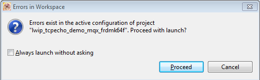

I keep getting this message when I debug:
I have checked it against configurations that I had been using in KDS 2.0 and they are identical.  I even get this when debugging the demo applications.  How do I get details about the specific errors, and how would I then fix them?
If I proceed, everything seems to run normally, and I can still use the debugger.

Alice, I'm not sure what happened, but I recently rebooted my computer, and now I don't get this problem anymore.  :smileyhappy:  Weird!

FWIW, I've observed this on occasion in KDS_v3 as well (on Mac OSX 10.12.6 / Sierra).  Quitting and restarting KDS has fixed it.
Now that I think about it, I saw this error dialog after I renamed some files out from under the project manager (e.g. "git rm xxx", etc), which probably confused it.

BlackNight
The usual cause of this message are wrong paths/settings in the project. See
"Errors exist in the active configuration..." Eclipse Dialog when Debugging - Stack Overflow
I hope this helps,
Erich

I could not find a wrong path setting in the project.
Deleting the launch configuration did not fix the issue permanently. The first debug session succeeded without this message, subsequent debug sessions prompted this message.
Deleting the current build folder (i.e., "Debug") resolved the issue for me permanently in one projectHowever, for a second project that "fix" didn't work.

dave408
Senior Contributor II
It's the one shown in my screenshot.  :smileyhappy:  lwip_tcpecho_demo_mqx_frdmk64f

dave408
Ah, I understand.  :smileyhappy:  Here you go: C:\Freescale\KSDK_1.2.0\examples\frdmk64f\demo_apps\lwip\lwip_tcpecho_demo\tcpecho_rtos\tcpecho_mqx\kds
