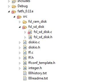

Update,
It appears, that I need to extract my SDK_2.0_K64F.zip in my C:\Freescale\SDK_2.0_K64F
Next, I deleted my existing FatFs file on my existing project, but now I am getting errors.
I realized that the project paths for the FatFs had to be changed, so I went ahead and made the
changes needed.
"${ProjDirPath}/fatfs_0.11a"
"${ProjDirPath}/fatfs_0.11a/fsl_sd_disk"
Any suggestions?
Hi Neil,
I have added a screenshot to make it clear.
Erich
