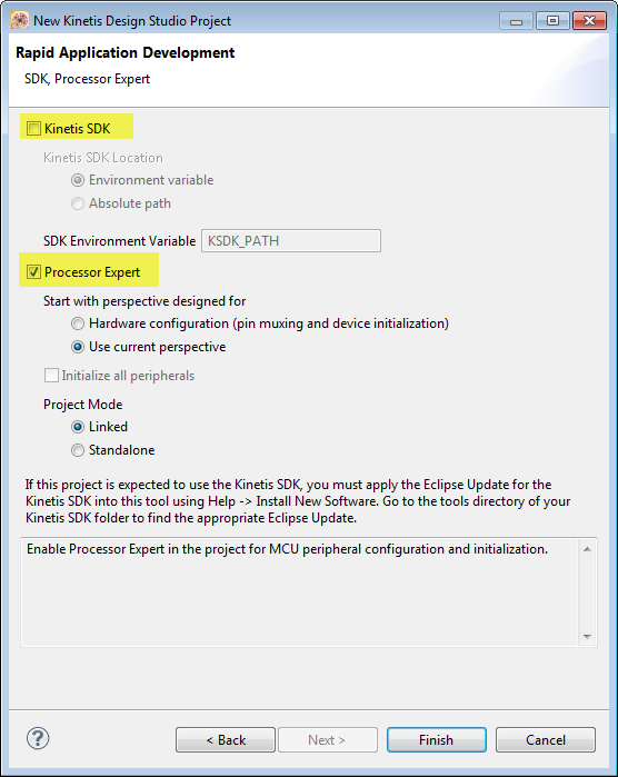

Hello Eric
Thanks - appreciate the support and happy to say what I'm finding.
I've come up with another issue - I don't know if I'm missing something really basic.
I went back into start another project - my aim is to test the USB HOST MSC writing to a USB Stick.
Following the tutorial, exactly as before, as soon as I add the first pin to the project Bit1:BitIO_LDD it is marked with a red x - and the tab Problems has
"Errors: ERROR: This component is not supported in Kinetis SDK project mode. "
I seem to have upset the Processor Expert somehow and don't seem to be able to get it back.
I've tried a number of different approach to just generating one bit correctly, closing the project,rebooting my machine to make sure all processors are dead, but it isn't working.
I've closed all unrelated projects.
I would add a snapshot jpg but, its disabled in this editor.
So I must be doing something really basic wrong but I can't figure it out. Should I switch workspaces?
thanks for any help
Hi Neil,
it looks you have created an SDK project in the wizard with PEx.
the thing is this: with using the SDK, it is not possible to use any of the LDD projects. You only can use components designed for the SDK.
There is no easy way to convert an SDK project into a 'non-SDK' project, as there are a lot of internal dependencies.
If you want to use LDD or any 'non-SDK' projects with the Kinetis SDK, then make sure that SDK is *disabled*:
Erich
Ok Got it. Didn't realise they were different. Many thanks.
