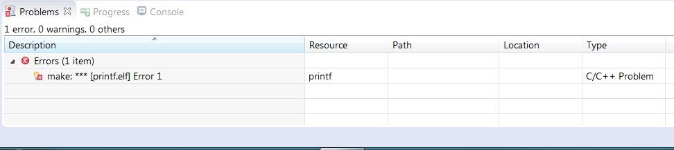

I repeat printf to console  steps defined in “pdf” file:  #1.1 (page 2) and  #1.2 (page3).
  1. Working with new KDS v3.0.0 - No print to console
  2. Building the projects in KDS v2.0.0 - There is a print to console
  3. Importing the “FRDM-K64_printf_UART_baraboad.zip” project fail during Build debug with make*** [ProjectName.elf] error 1
KDS v2.0.0 and KDS v3.0.0 are using different libraries.
See Semihosting with Kinetis Design Studio | MCU on Eclipse  how to do semihosting with KDS v2.0.0.
See Semihosting for Kinetis Design Studio V3.0.0 and GNU ARM Embedded (launchpad) | MCU on Eclipse  how to use semihosting with KDS v3.0.0.
I hope this helps,
Erich
