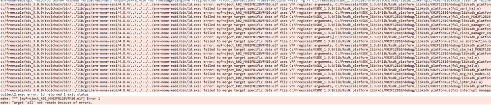

When create a new MK02FN128 KSDK project with  SDK Project Generator (http://www.nxp.com/products/software-and-tools/run-time-software/kinetis-software-and-tools/developm... ) or KDS3.0 project wizard, even the new created project has build errors:

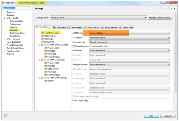

Open ksdk_platform_lib_K02F122810 with KDS3.0, there is wrong setup in ksdk_platform_lib_K02F12810 properties setting: the default target
processor is cortex-m0plus!

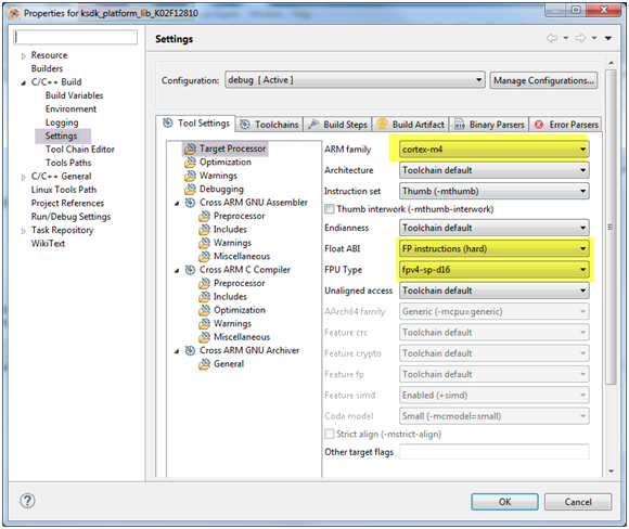

Because K02 is cortex m4 core, obviously we need modify ksdk_platform_lib_K02F12810 target setting to cortex-m4 instead:
After above revise, rebuild the library project.
Then rebuild user project. The errors are gone.
