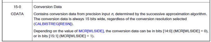

I have selected the ADC resolution from CALBISTREG Register as 12bit, but in the CDATA register when I am reading the ADC data, I am getting the value for 15bit resolution.
May I know the steps to read the ADC data from CDATA in terms of 12bit resolution.

Hi@truptikavadi1
The description of this register is very clear. If you have any questions, please let me know.

I am configuring the ADC for 12 bit resolution. So the maximum count i am expecting is 4095 with 3.3 V at the ADC pin.
When i read the CDATA register the value is approximately 32700.
How can i map it with a 12 bit resolution?
If i configure the same to 8 bit i am expecting the maximum count to be 255 and for 10 bit 1023. But for all the bit resolution configured i am getting ~32700 which is the maximum value for 15bit.
Can you please help me with mapping these values?

Hi@truptikavadi1
https://community.nxp.com/t5/S32K/S32K344-ADC-data-alignment-and-bit-resolution/td-p/1571229
So your case:
32700->0111111110111100->0b0111111110111100->0b111111101111 = 4079.
