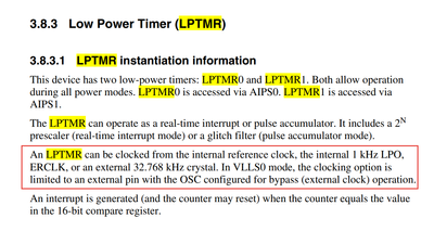

Joey_z
hi,Jagir_Mehta1
Thank you for contacting us.
The LPTMR can use the LPO and external crystal, you can try using the external crystal for the LPTMR.
In addition, are you using the SDK demo to test the 15.000 sec? if not, If not, please ensure that the LPTMR ISR is not influenced by other ISRs.
Hope it can help you.
Joey

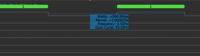

Joey_z
hi,Jagir_Mehta1
Thank you for your reply.
I think you should cheek the value of counts.
set LPTMR_USEC_COUNT 1000000U, about 1s have the offset 0.5ms.
set LPTMR_USEC_COUNT 1005000U, the offset is lower.
In addition, I use the LPO to test it, but external crystal is less susceptible to outside influences, you can consider using it.
Joey
